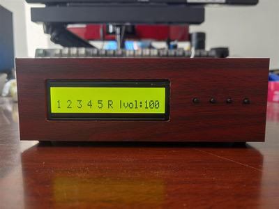

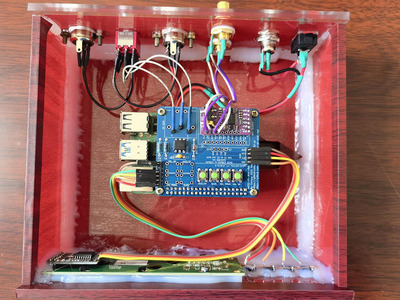

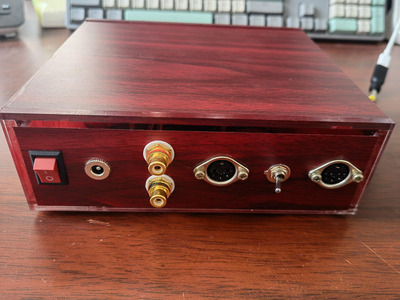

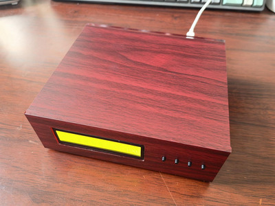

Reply 85 of 86, by zwrr

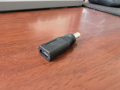

Thanks to Dwhinham and Chris-JH for creating the MT32-PI and MT32-PI-MIDI-Hat projects.
It costs about $85 in total to build it.
Poor handwork, ignore those lots of hot melt adhesive...
I installed two DIN5 inputs and used a toggle switch to switch input sources, which can connect my K6-2 old PC and new computer at the same time.
For the power supply part, I used a Type-C to 5.5*2.5mm converter.
93.47 KiB
613 views
141.44 KiB
613 views
134.88 KiB
613 views
199.94 KiB
613 views
110 KiB
613 views

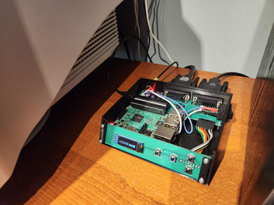

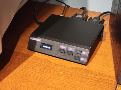

Reply 86 of 86, by conzyor34

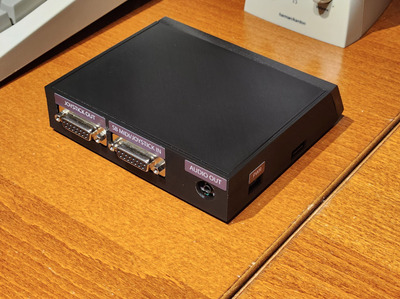

I took my build in a slightly different direction than others I've seen. Rather than having standard MIDI ports, my custom PCB connects directly to the DB15 Joystick/MIDI connector on most old PC sound cards. I included a joystick passthrough so I can continue to use my joystick by connecting it to the box. I went with the traditional enclosure shape. I wish I had a good way to transfer tiny text for the button labels onto the front panel as I'm not entirely happy with the stickers. In retrospect I wish I had included a power LED somewhere and a MIDI message LED on the front. I don't think I'll regret limiting myself to DB15 Joystick/MIDI only; retro games are the only use case I am concerned with.
313.54 KiB
469 views
458.84 KiB
469 views
359.46 KiB
469 views
The mt32pi project is incredible! Thanks to everyone involved with that project, and thanks to you all for posting your builds.
