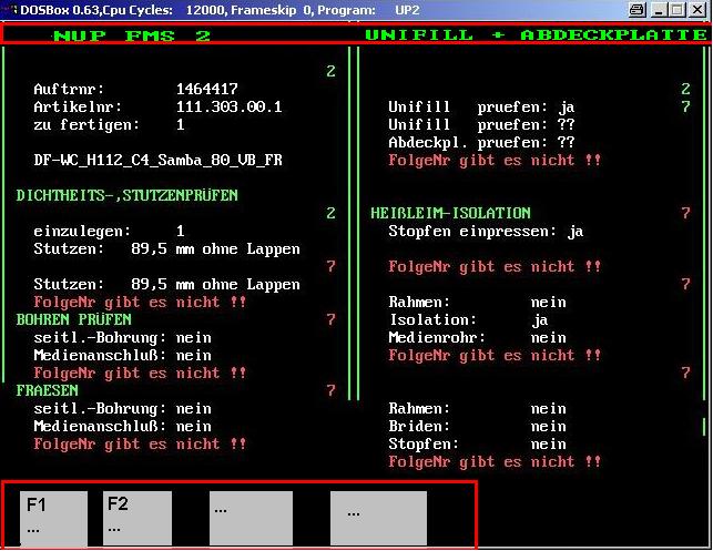

But now I have to get an older program for a machine control (so it's not a game) to run on a Win2000 machine.
I tried with dosbox 0.63 and after a silly problem it worked... I thought

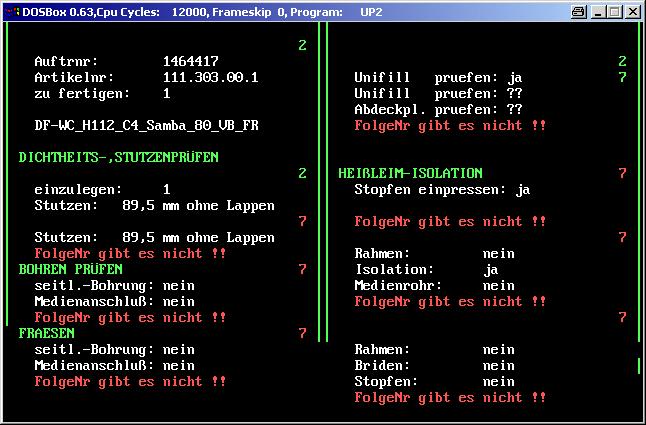

In my screen there are some lines cut off. The title doesn't appear (only when I refresh the screen by hitting enter it appears for less than a second) and at the bottom there must be a line with the description of the different function keys.

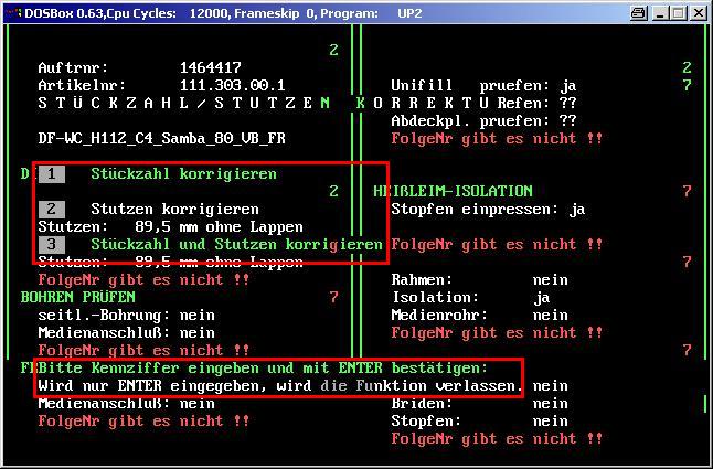

When I press e.g. the F2 key, it works partly, but the screen isn't refreshed. (I think that's one of the problems) So I have the 3 or 4 lines of the new screen thrown over the text of the first screen (see Dosbox_screen2)
As the command "mode con cols=80 rows=50" seems not to work in dosbox I ask for help, if anyone knows a way to enlarge the screen size.
I have disabled all sounds on one machine but not on the other, but the problem is the same...

    red marked fields don't show up, but should ;/

    red marked fields should be on a separate screen.

Reply 6 of 22, by `Moe`
This could be a bug (limitation) in DOSBox. As far as I have experienced, the built-in BIOS emulation doesn't handle text modes with more than 25 lines correctly (regarding scrolling and other text output functions). You could try to use a DOS boot image. Since you are not running a game, other solutions might be difficult - DOSBox is focused on games, and application problems are not always handled.

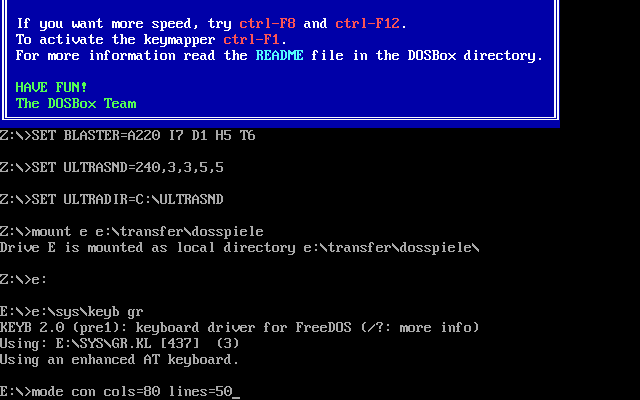

As HAL said, in this case you can try mode.com from freedos,
which should work fine for mode switching. You can create a
batch file then that loads mode.com with those parameters and
starts the program, so it doesn't impose much difficulty to the users.

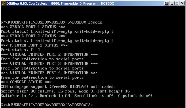

Reply 12 of 22, by Alessio
hmm... i have now a functionable mode.com, but it seems, that just the support for the parameter "con" is not loaded.

Reply 17 of 22, by h-a-l-9000
Rank DOSBox Author
DOSBox Author
Yes indeed.
