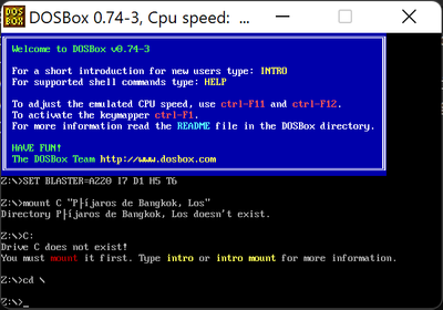

The folder name is indeed the same you show in your capture. I'm attaching the .conf file.
I'm also noticing another issue... the same profile does work with plain DOSBox v.74-3, but won't work with DOSBox-X. It launches DOSBox-X, but it seems to ignore the lines at the [autoexec] section of the .conf file.
I'm using DOSBox-X 0.84.1 MinGW SDL2 x64 build.

Reply 1801 of 1968, by rcblanke
Your .conf is working fine here, at least in DBGL. In DOSBox, on the other hand, things break like so:
12.12 KiB
3183 views
Pájaros
I *think* this is a DOS or DOSBox limitation. AFAIK the dosbox configuration file should be encoded in UTF-8 (as is the default dosbox.conf), which it is.
But if anyone more knowledgeable on file encoding/charsets/codepages is able to shed some light on this problem, I'm all ears. If this can be fixed, I'd very much like to do so.
Reply 1802 of 1968, by Neville
Mmm... If I uncheck the "Close when exit" box in DBGL, that's exactly the same error I'm getting. Only that mine occurs inside DBGL as well.
I've also been doing more testing on my DOSBox-X issue. Profiles using that build work on my regular install, but not on my backup one. The only difference I see between both is that the later runs from D:, my second harddrive. But this shouldn't matter, right? And I'm using the exact same build in both places.
Reply 1803 of 1968, by rcblanke
Correct, this shouldn't matter. Maybe also uncheck "Close when exit" to see what's going on (or right-click on a problematic profile and choose 'Start manually' to see if the mounts are working).

Reply 1805 of 1968, by Neville
I think we can forget about my DOSBox-X issue, it seems that some builds of DOSBox-X are to blame and not DBGL. I've been also testing my other DBGL profiles with accents in the pathnames and all seem to work. I just found another problematic one, however: "Asterix: Operation Getafix". Either DOSBox or DBGL don't like that I accentuate "Asterix".
Reply 1806 of 1968, by _Rob
Neville wrote on 2022-08-06, 12:49:
I think we can forget about my DOSBox-X issue, it seems that some builds of DOSBox-X are to blame and not DBGL. I've been also t […]
That looks like a codepage problem. What codepage are you using? If you run the `keyb` command, it will print the codepage. It seems you are trying to use characters that simply don't exist in the standard DOS 437 codepage. https://en.wikipedia.org/wiki/Code_page_437
So you either need to use a different codepage (e.g., 852), or avoid using those characters.
update
I tried it myself by starting dosbox-x as such and I see the same problem with codepage 858:
dosbox-x -c "keyb es" -c "mount C 'Pájaros de Bangkok, Los'"
So I suggest to open an issue on the dosbox-x issue tracker.
