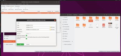

@rcblanke: thanks for alpha5. regarding portability, i moved dbgl to its former location and upgraded it. when starting the new version, the layout returned to default setup. also, a hidden .dbgl folder is now created under home upon every start, still making it not as portable as before.
forgot to mention the .dosbox folder under home, which is also created, btw.

Correct, the various DBGL 0.90alphaX packages only contain /lib/swt.jar files for 64-bit operation systems. If you really want to use DBGL 0.90 on a 32-bit system, you'll need to download the appropriate latest SWT release for your OS - in your case you'll need this. Extract the contents of the archive and rename swt.jar to swtlin64.jar and copy it into your dbgl/lib folder, overwriting the existing file there. Then DBGL should work on your Puppy Linux just fine, methinks.
dbgl-user wrote:
regarding portability, i moved dbgl to its former location and upgraded it. when starting the new version, the layout returned to default setup. also, a hidden .dbgl folder is now created under home upon every start, still making it not as portable as before. forgot to mention the .dosbox folder under home, which is also created, btw.
Well, the ~/.dbgl folder is DBGL's default location for user-generated content such as profiles, templates and the like, but if you just want to use the main dbgl directory for this data, simply edit the ./dbgl startup script and set the parameter dbgl.data.userhome=true to false, like so:
#!/bin/sh
export SWT_GTK3=0
symlink=`find "$0" -printf "%l"`
cd "`dirname "${symlink:-$0}"`"
"${JAVA_HOME:-/usr}"/bin/java -Djava.library.path=lib -Ddbgl.data.userhome=false -jar dbgl.jar
If you already have created some content, you will probably want to copy/move the existing data in ~/.dbgl into your main dbgl directory. Regarding the .dosbox folder, I think that is the default location for dosbox.conf, but if you want to make it all portable, put DOSBox' executable and dosbox.conf into a subdirectory of dbgl and configure it as such in DBGL (see attached image).
