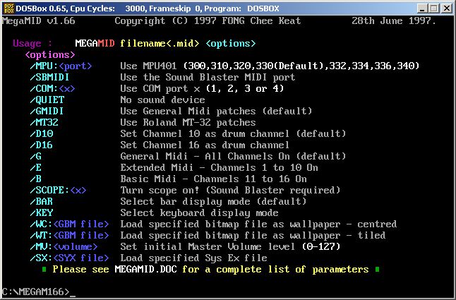

I've had a fair look around but can't find anything on this... I'm also a DOS Box newbie by the way.
What I want to do is play MIDI files using DOS Box's OPL emulation.
I downloaded a MIDI player called Mega Mid. When I try playing MIDIs through it with my default setup, it simply puts it through to Windows (which ends up being some awful wavetable crap). I'd like it to play using the OPL emulation. How should I go about this? Is it something in DOS Box's config, Mega Mid's config, or a both?
Here's Mega Mid's options:
    76.09 KiB
    1406 views
Reply 3 of 6, by gulikoza
OPL is not General Midi compatible. Most games used custom drivers for OPL chips.
One solution however is to play midi files in Windows (Win31 inside dosbox 😀) with a media player. That will play through OPL chip, but I'm not sure how accurate the playback is (well, how accurate is OPL anyway 😁)
http://www.si-gamer.net/gulikoza
Reply 5 of 6, by Freddo
Years ago I used DJGPP and Allegro and with Allegro there was a small example program that play MIDI files. I just tried that example program in DOSBox 0.65, and it's very possible to use it to play MIDI files thru OPL3. At least the playback is accurate enough for me.
Cubic Player is probably able to play it too, but I haven't tried it.
