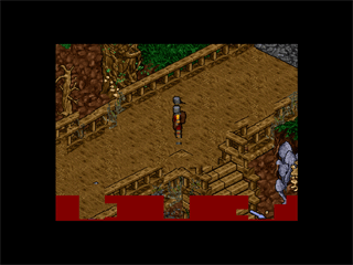

I use DosBox under WinXP with a LCD monitor, connected through DVI to a nVidia GeForce 6600GT.
In DosBox 0.65 I like to play games whose original resolution is 320x200 with the following configuration:
fullscreen=true
fullresolution=desktop
output=overlay
aspect=true
scaler=advinterp3x
(For example Ultima Underworld 2 or Ultima 8 )
In DosBox 0.70 this configuration creates:
1) nasty corruption of graphics (a mix of 4/3 and 16/10 aspects ratios on the same screen)
2) sometimes a reduced dimension of the screen, depending on the "output" setting.
I have tried with different settings and my conclusion is that this behavior is due to the combination of:
1) fullscreen
2) aspect set tro true
3) using a nearly all the scalers, except "none" and the "normalxx" ones
Does anybody else have the same problems?
Is It a problem of my hardware configuration or a DosBox bug in the last version?
Thanks in advance,
Simon_owl

The LCD screen is a 4:3 in native resolution 1400x1050.
Using different resolutions in "fullresolution" setting doesn't remove the problem.
Only using the "output=ddraw" setting the image is OK: everything from "surface" to "opengl" corrupts the screen, when used in conjunction with "aspect=true" and complex scalers as "advinterp3x".
Note that "scaler=none" works perfectly!
I have attached a screenshot showing the problem.

Reply 4 of 8, by ADDiCT
Hmmm... This looks like an "effect" (bug?) in the game, not DOSBox, but that's just a guess. Do you see the same effect in UUW2? Could you test this with some other games?
Unless you have a need for a specific scaler, why don't you use the ddraw/no scaler combination for now? I believe this is the perfect combination, as it shifts the workload of scaling from the CPU to the GPU, and the picture quality is quite good IMHO. It might be interesting to further investigate this topic, though. There may be a bug in DOSBox that could be fixed.
Btw, did you upgrade to the latest NVidia drivers? I've used ATI cards exclusively over the last years, so i don't have experience with NVidia, but from what i read in various forums, certain versions of the NVidia drivers often have troubles with specific games or applications.

Reply 6 of 8, by wd
Rank DOSBox Author
DOSBox Author
See the troubleshoot section of the readme.
Especially assure that you use a fresh dosbox.conf and only change
the entries that are present, AND only change them to valid items.
And see if setting SDL_VIDEODRIVER=windib helps if it still occurs.

Thanks!
Setting the environment variable SDL_VIDEODRIVER resolves the problem!
(but I don't understand the different behavior between 0.65 and 0.70 - for example if I set SDL_VIDEODRIVER in 0.65 the savefiles of the games are corrupted)
