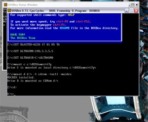

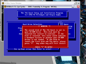

Reply 7 of 12, by nitromike2006
Here are two screenshots that should help with my problem. The first shows how I am mounting my drives under DB 0.72 and the second shows the error on top of the install after typing INSTALL at the D: prompt.

Reply 8 of 12, by ripsaw8080
Rank DOSBox Author
DOSBox Author
I didn't see the error message at first because it's stored in the executable as text mixed with screen color attributes. The message starts with "The first disk of..." in the install program I have, although that message doesn't come up during install. It's strange that this installer you're using refers to the second disk and then a bit later contradicts itself by referring to the first.
I downloaded a patch for The 7th Guest called T7GFIX3.ZIP that includes an updated version of INSTALL.EXE, 43704 bytes, dated 7/23/1993 6:55 PM. If I change to the install directory "CD \T7G\INSTALL" on the CD and then run the updated installer from the C drive "C:INSTALL", I get the exact same error you do, including the contradictory reference to both discs. Since this updated installer couldn't replace the one on the original CD, it seems it was only intended to be used to re-configure hardware choices in an existing installation. Perhaps you have discs that were "reauthored" with CD software to use the patched files instead of the original ones. However, if your discs are original, it's unfortunate that you have the problematic version of the installer. 😒

You can get around the problem by "manually" installing. Copy all the files in the \T7G\INSTALL folder on disc 2 into an installation folder on your mounted C drive. Then create a file in your installation folder called GROOVIE.INI with the following contents:
;ini File for The Seventh Guest
;(C) Copyright 1992 Trilobyte, Inc. and Virgin Games
[main]
VideoCard=VESA
midi=SoundBlasterPro2
pcm=SoundBlasterPro2
svga=on
ProgDir=C:\id\t7g\
DataDir=D:\t7g\
Recommended=SVGA
CPU=486dx
FreeMem=637
CDbench=18636
[SoundBlasterPro2]
irq=7
port=220
xmi=sbp2fm.adv
pcm=sbpdig.adv
dma=1
Change the ProgDir and DataDir paths to reflect your setup. Now when you run the INSTALL.EXE in the installation folder, it should only reconfigure the settings rather than do a full file-copy install because the config file is there. The config data I've posted here is from the original install, so definitely re-confgure for the settings you want to use with the newer installer; but using this as a starting point should get you going.
