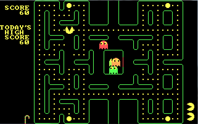

Now you've got me confused again. Take a look at these screenshots taken from windowed mode with the Windows snipping tool (so the resolution matches what I actually see on the screen).
This is a 320x200 CGA game and as you can see the aspect=true screenshot looks vertically stretched. My display is a laptop with a native resolution of 1280x800.
aspect=false
scaler=normal2x
result: 640x400
aspect=true
scaler=normal2x
result: 640x480

To display 320x200 (8:5) on a 4:3 monitor using the full area it has to be stretched vertically. The pixels are not square in this mode. And that's what the hardware back then did.
640x480 is not stretched as it already is 4:3. The pixels are square.
Nowadays the pixels of a common LCD monitor are square. So in windowed mode (assuming your desktop resolution is the native resolution of the LCD), It can display 640x480 in a correct aspect ratio without scaling. But 320x200 has to be scaled to look as it did back then.
In fullscreen things are different as nobody can know what your video card together with the LCD monitor produce when they are switched to one of the old 8:5 modes - if they produce anything at all. If the effects are not what you desire you'd set fullresolition to a value which produces square pixels on your screen. Aspect=true then scales the 8:5 output to 4:3 as in windowed mode.
Well I'll be honest here and say I can't remember what the games looked like back then. PC-Man was one of the earliest I played on my Commodore PC-10 but it's been ages. I will not doubt your technical expertise when you say a full screen picture back then was stretched.
But, having said that, isn't it a bit curious the chosen resolution for CGA was 320x200 when this in fact could not be displayed correctly on a standard monitor (unless you had black bars that is). Does anyone know the reasoning behind this? And how it looked when hooked up to a TV instead?
Also, did any developers try to adjust for this kind of vertical stretching by reversing the processing? As in, storing a squished picture in 320x200 that would look right when stretched to 4:3? Somewhat like anamorphic DVDs.
Read again what hal posted, that's exactly where the non-square pixels come
into play (320x200 cga DID fill the full 3:2 screen without black bars).
Some games were designed with square-pixel ratios in mind (like no correction
when drawing circles), which looked/looks not-fully-correct by times if it is
noticeable at all. Most games were simply written to "look nice" on the
standard 320x200 for a 3:2 screen.
