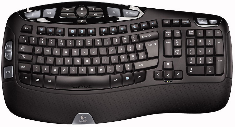

I've had some problems with my keyboard and OS X, some Dosbox keycombinations would not work regardless of what I did.
After many investigations with the help of Rhoenie and Tryton (that's ripsaw or robertmo, not sure who is named Tryton on IRC) I found that my problem was caused by two things:
1.)I was using a Logitech keyboard (cordless wave) that even though it is supposed to be mac compatible, it isn't really.
Without the Logitech software (LCC) some things do work but the moment you switch command and option (ALT) key in the OS X keyboard settings (to make the layout behave like a real mac keyboard layout) you are losing your right ALT key, since OS X assigns the left ALT key functionality to the right ALT key (this is only bad when you want to use the german keybaord layout in DOSBox -> you can't type \ anymore). Also this keyboard has one key for both Scroll Lock and Pause, no matter what I tried, I couldn't get it to work as Pause key.
Basicly the same stuff happens when you use the Logitech drivers, except for the missing right ALT key functionality some F-keys behave differently unless you explicitly tell the software to have them behave normally.
But for example F12 is assigned to be the eject key and thus not always works in DOSBox.
2.)In the end I ditched my beloved Logitech Wave keyboard (which is really a joy to write on) and switched with my gf's apple keyboard with numpad.
When I did that I found the solution to another problem, which plagued me, some F-keys were behaving differently.
Solution was to look much more closely at the OS X system control settings.
- in the keyboard settings in the tab "keyboard shortcuts" some of the DOSBox shortcuts were already given to something else. Especially the Exposé and Spaces settings grab some F-keys.
- In the Exposé and Spaces settings themselves the key F8 is setup to start Spaces (multi-desktop program), and EVEN though I had disabled Spaces alltogether it blocked the use of F8 in DOSBox. Assigning anoter key fixed that, thankfully.
(- since the Apple keyboard does have an extra eject key to the right of F12, the F12 key worked flawlessly right away in Dosbox, not like that stupid Logitech keyboard)

To make clear what I'm talking about, there is the Logitech Keyboard Cordless Wave, closely resembling that one http://www.amazon.de/Logitech-Cordless-Deskto … 57&sr=8-2-fkmr1 (this is not the qwertz layout of the german one, but I couldn't find one right away).
and there is the Apple keyboard with numpad http://store.apple.com/de/product/MB110D/A?fn … mco=MTMzNzcyMDM
The Logitech one is the one where I only have print screen, scroll lock and nothing else. Instead of the F13 key it has the insert key up there (as can be seen on the amazon link), so it got F14, F15 but no F16 and following.
The Apple one is behaving like explained, with the problem that the pause key is not working like expected.
The Apple keyboard became mine now and the Logitech is now my gf's 😀
http://www.benchmark.pl/uploads/image/wave.jpg
i see only ins, print screen,pause break, no scoll lock
And keyboards that had only three extra f keys were numbered this way:
print screen (f13), no scoll lock (f14), pause break(f15)
so you have only f13 and f15, while f14 is missing
although i think it would be rather unusual not to have f14 so i guess your keyboard is just "the first standard" with only f1-12 and no more extra mac f keys, i guess these keys are only used in windows.
Unless you say that they indeed were working like f13,14,15 in mac. 😀

On the Logitech with Logitech drivers the behaviour and layout was
F12 Eject - this made it only sometimes register as F12 in the mapper
Insert
Print Screen
Scroll lock (even though it says Pause on the key lettering).
On the Logitech WITHOUT Logitech drivers:
F12
Insert
F13
Scroll lock
So on the logitech with logitech drivers, both F13 and Pause (F16) are missing.
Without the drivers, both F14 and F16 are missing.
On the Alt key issue, with the logitech drivers you have the choice to keep the layout like on Windows: ctrl-cmd(windows key)-alt-space-alt-fn-ctrl
Or as on the Mac (as opposed to the picture you posted of the wave, my keyboard has dual markings on alt, windows key to easily see the mac layout):
Ctrl-alt(windows key)-cmd-space-cmd-fn-ctrl
You can then further customize the fn key and assign it the function of either alt,cmd,ctrl or shift. Unfortunately when you assign it alt it gets the left-alt-key function 🙁
Without the logitech drivers:
Ctrl-cmd(windows key)-alt-space-alt-NO_KEY-Ctrl
The Alt keys get recognized as left and right, the Fn key is not recognized at all (neither in the mapper, nor in OS X at all, it seems)
Edit: I added the results for the Logitech keyboard WITHOUT the drivers
