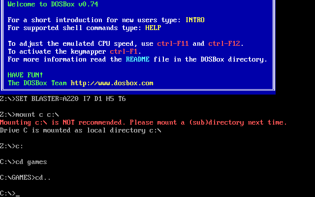

Aftewr mountying my c: drive to a particular directory I am unable to change directories back to my root directory.
I've tried:
cd ..
cd c:\
No error messages. Neither works, I seem to get stuick in the cuirrent folder unless I change to another folder under c:\.
Any suggestions?

If you are still in Z:\ type C:
Without the slash.
If you are in C:\ try cd\

Reply 5 of 20, by JamesJoey123
I really didn't see anythinbg there as to why I'm, unable to change to c:\.
Currently in the configuration file's autoexec section I have:
mount c c:\games.
The only way I have found that I'm able to get to c:\ is to change the line to:
mount c c:\
And then if I change directories I can't get back to c:\.
While in dosxbox I tried remounting by using:
mount c c:\ but it told me 'mounting c:\ is NOT recomended and I remain in the same directory.

Reply 17 of 20, by DosFreak
If you mount c:\games to c: then you can "cd" to any subdirectory of the c:\games directory.
You CANNOT cd to any directory above the c:\games directory because you only mounted c:\games.

Reply 19 of 20, by TeaRex
In other words, as far as the software running inside DOSBox is concerned, the directory you mounted to C:\ IS your root directory.
The whole point of this is to set up a "cage" of sorts that the software cannot leave. Remember DOS is an unprotected operating system: Any program running in it is allowed to do anything at all with your system. So to prevent DOS programs from running amok with your whole (real) disk, DOSBox keeps them under lock, so to speak.
If you know about computers, you'll have heard of a "chroot jail". It's the same concept.
