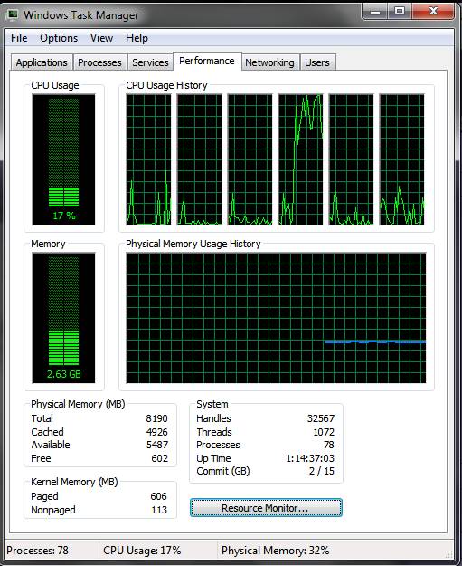

That P4 probably has an AC'97 "codec" audio card...in reality, that's the CPU working, also, on a multicore system when only one core gets extremely loaded the total CPU usage won't reach 100% (look at the attached pic. I'm using ~100% of one core).
    71.58 KiB
    900 views

Reply 17 of 17, by bloodbat
robertmo wrote:
bloodbat are all 6 cores uses when you play .mp4 movies? do all go to max when you use fast forward? If you switch to 12 threads are they all also fully used? And what is your cpu?
I don't know what that has to do with this thread, as I was only demonstrating what I explained by using a program I wrote to set the core to max usage; but...to answer your question...no. I'm watching a 1920 x 800 mp4 while I type this and total CPU usage is at ~7-10%, divided among all six cores. They didn't go to max when seeking (not even halfway). The CPU is a Phenom II X6 1090T. The program used to play the mp4 is Media Player Classic Home Cinema x64, whatever the latest version on their website is. Now...why do you ask?
