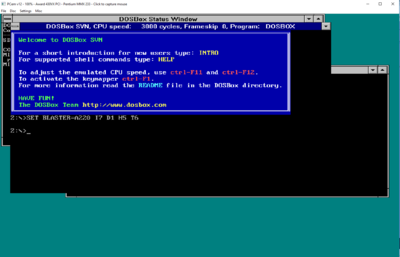

Now includes DOSBox binaries for NT 3.51, 95, 98+ and XP+ 64bit compiled with Mingw and Mingw-W64 w/ gcc 7.x.0

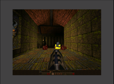

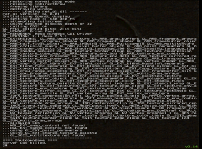

Got Mesa 7.5.1 to work on Windows 95.
7.10.3 is the last ver to support Visual Studio. 6-13-2011 OpenGL 2.1
Download: https://mesa.freedesktop.org/archive/older-ve … ions/7.x/7.5.1/
Compile with VS2008 and LegacyExtender
EDITVERSION from LegacyExtender should work if not then use VS2005 EDITBIN
EDITBIN from VS2005 C++ Command prompt "editbin /subsystem:windows,4.00 /osversion:4.0 opengl32.dll"
https://www.gamingonlinux.com/wiki/Building_Mesa_from_source
Copy opengl32.dll to quake 2 directory to test.

https://sourceforge.net/projects/msys2/files/ … POS/MINGW/i686/
https://sourceforge.net/p/mingw-w64/bugs/599/
https://github.com/Alexpux/MINGW-packages/issues/2282
https://github.com/pal1000/mesa-dist-win
http://forums.thedarkmod.com/topic/17867-comp … ws/#entry391478
Possible issue with MSYS2 and GCC. Works fine with MSVC
https://github.com/Alexpux/MINGW-packages/issues/2089
mingw-w64-i686 standalone with dwarf exceptions and posix threading
Possibily fixed in GCC 7.2.0
    Mesa3D-Win32-7.5.1-95+.zip

So did some testing with HXRT and DOSBox and found out that vmware was causing the issues with the mouse.
Using PCEM v14 (not 12!!), HXRT and DOSBox AND with SDL_Videodriver=windib then no mouse issues!
If recompile sdl 1.2.15 and allow new code to apply to all OS instead of just 9x then would probably work but there isn't much point.
If PCEM v12 set then DOSBox displays no video
If SDL_Videodriver not set then mouse issues.
Need to look into setting dosbox.cfg or dosbox.ini in dosbox code although dosbox still reads "dosbox.conf" as "dosbox.con" in DOS anyway.

Reply 7 of 60, by DosFreak
Finally got DOSBox working in NT 3.50. Wasn't that difficult but did take all day since I don't know what I'm doing.
Windows NT 3.50 was released September 21, 1994 making this the oldest version of Windows that can run DOSBox.
Use the attached with the previously posted msvcrt.dll.
Also keyboard doesn't work for some reason. Likely due to the changes I had to make to DOSBox. Need to figure out how to disable the mapper or rather the joystick part of the mapper without butchering the code. Same behavior on Windows 10.
For DOSBox to work in NT 3.50 SDL has to be modified to remove changedisplaysettingsa which means that SDL can't use fullscreen in NT 3.50. Also joystick support has to be removed from SDL which also means it has to be disabled in DOSBox.
Next:

Reply 8 of 60, by DosFreak
DOSBox on NT 3.50
Okay figured it out with a workaround until/if I can figure out how to disable the joystick in DOSBox:
Note that below joystick support has not been disabled in either SDL or DOSBox so the executable will error out on NT3.50 with joygetposex error in winmm.dll.
Simply copy winmm.dll from NT3.51 to the DOSBox directory on NT3.50 and execute
SDL
"./configure --disable-shared --disable-directx --disable-video-opengl CFLAGS="-O3 -march=i386 -mtune=i386" --prefix=/mingw"
C:\MinGW\codeprojects\dosbox\32\vanilla\SDL-1.2.15351\include\SDL_config.h
Add
#define NO_CHANGEDISPLAYSETTINGS 1
DOSBOX
./configure --enable-core-inline LDFLAGS="--static -s" LIBS="-lsdl_net -lwsock32" CXXFLAGS="-O3 -march=i386 -mtune=i386" CPPFLAGS="-I/mingw/include/libpng16" --disable-opengl --disable-ddraw --disable-profile --bindir=/mingw/bin --libdir=/mingw/lib --includedir=/mingw/include --prefix=/mingw
Also it turns out fullscreen does work in NT3.50 but it's a fullscreen window versus true fullscreen. The more things change the more they stay the same.....
Need to see if can turn into a configure switch for SDL
Also likely that joystick doesn't work, this just satisfied the dependency.
Getsystemtimeasfiletime not caused by MINGW but by msvcrt.dll
To bypass this error then need to use a msvcrt.dll that does not include getsystemtimeasfiletime.
See attached.

Setup Windows OS VMs for testing. vbempj for NT3.51 in pcem works
