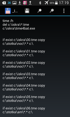

Reply 5 of 6, by BulmaSoft
mrau wrote:
instead of spamming files You could use errorlevels; time will not always be so exact in an emulated environment without synchronisation;
If I knew how to do that - I would!
And Yes - DosBox does have the option to synchronise time with the host (on Android).
It is: Time /H
(/H switch)
And it works.
This is the Bat file that is being used (image)
