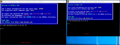

Reply 12 of 29, by kjliew
Qbix wrote:
the windowsize of the dosbox window is the same in both cases (just to make sure that not some highdpiscaling flag is set for the dosbox exe in the register) ?
Can you confirm that both dosbox windows have the exact same size ? (as that was a problem I once had while testing some of the opengl scaling code)
NO, they are not, in raw screen pixel term.
With display scaling at 100% (no scaling), if DOSBox starts a 640x480 game, then it will occupy a 640x480 window on screen.
With display scaling at 125%, if DOSBox starts a 640x480 game, the OS will scale and become 800x600 window on screen.
I thought you should have known that from the code in sdlmain.cpp:1267.
#if SDL_VERSION_ATLEAST(1, 2, 10)
#ifdef WIN32
const SDL_VideoInfo* vidinfo = SDL_GetVideoInfo();
if (vidinfo) {
int sdl_w = vidinfo->current_w;
int sdl_h = vidinfo->current_h;
int win_w = GetSystemMetrics(SM_CXSCREEN);
int win_h = GetSystemMetrics(SM_CYSCREEN);
if (sdl_w != win_w && sdl_h != win_h)
LOG_MSG("Windows dpi/blurry apps scaling detected! The screen might be too large or not\n"
"show properly, please see the DOSBox options file (fullresolution) for details.\n");
#else
The screenshot for DOSBox side-by-side, with Scaling 125% (left) and No Scaling (right) on 2560x1440 display with 125% scaling. DOSBox WIN32 used for No Scaling representation.

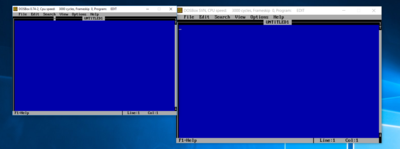

Reply 14 of 29, by DosFreak
I was referring to to the window size in the conf in the previous post, attached is a pic showing dosbox 0.74-2(left) and build 46 (right)
You can also see the cursor trapped in the bottom right-hand side of the window in the right pic.
When WINDIB is set the window size is still the same but the mouse works properly.
