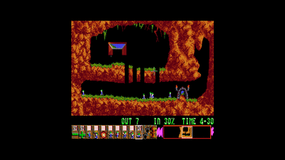

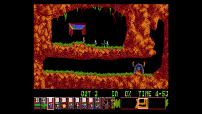

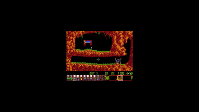

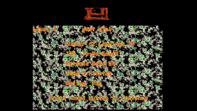

OK, generated a "blank" config file by DosBox itself and just changed the above settings, and I got the result in attachment.
In the meanwhile I also tried the dosbox version from here: https://github.com/bladeSk/DOSBox-pixel-perfect and I was able to get what I wanted (see other attachment "Pixel Perfect Patch") but only this does not work with "vgaonly". Only works with svga_s3, which results in some colors being off, especially in the screens where the levels are explained (see attachment "colors").
    129.33 KiB
    1257 views
    Colors
    41.77 KiB
    1257 views
    Dosbox ECE
    101.38 KiB
    1257 views
    Pixel Perfect Patch

I got this in the DosBox window (I guess that's the output window). Seems openglpp is not supported. (stderr.txt and stdout.txt stayed blank)
DOSBox version SVN
Copyright 2002-2019 DOSBox Team, published under GNU GPL.
CONFIG: Loading primary settings from config file lemmings.conf
"openglpp" is not a valid value for variable: output.
It might now be reset to the default value: surface
MIDI: Opened device:win32
To be clear: I used the Dosbox ECE version r4301 I found here: https://dosboxece.yesterplay.net/ in the archive folder, since I read here on Vogons it was the last version supporting Pixel Perfect. Maybe that statement was not correct? (Found it here: Re: DOSBox ECE (for Windows & Linux))

Reply 18 of 28, by TomVDJ
Yep, the version before that works fine (R4296). For space quest it does exactly what I want. For Lemmings however it gives me this result: A screen of 960 x 800 with 4x3 pixels. While the aspect ratio is perfect, I'd prefer to have a 5x4 pixels with an aspect ratio that's slighlty off, but covering a much bigger part of my screen. Is this possible with your patch Ant_222? Is it able to scale with "halfs"?
So width would scale 2 and height 2,5, resulting in the original 640 x 400 becoming 1280 x 1000. The patch mentioned (https://github.com/bladeSk/DOSBox-pixel-perfect) seems to be able to do this, but fails on supporting the vgaonly option... 🙁.
    75.18 KiB
    1225 views
    Screenshot
