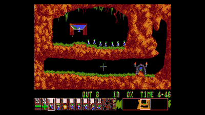

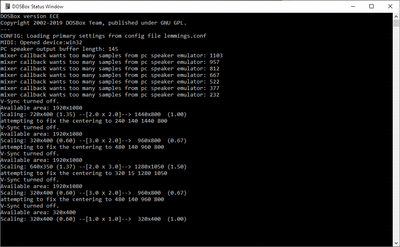

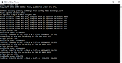

You are right about the vgaonly. This indeed seems to have impact on the "original" resolution. If I put it on svga_s3, the original resultion of the playing screen indeed is 320x200, and it scales perfectly, just like the other patch does. (see attachment of the result in ECE with svga_s3 instead of vgaonly). Also here the colors are way off...
In attachment the output screens when I start with vgaonly and with svga_s3.

Would be great. While searching for "dosbox vgaonly doublescan" in google, I came across this old thread of yours, so seems this has been an issue from the beginning: Double-height and double-width
Let me know if I can help with providing more info or whatever...

[dosbox]
machine=vgaonly
...you get the correct colors, but then also the doublescan kicks in, and pixel perfect patches seems to not handle that quite well... If you don't mind less sharp pixels, you can have the correct colors...
