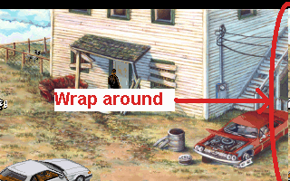

Hi all, I posted this problem about six months ago and got no resolution so I though I’d try again. When I try to run any games in DOSBox a small strip of the left side of the screen wraps around to the right side. I’ve tried messing with my monitor settings, screen resolution and even switched monitors and updated my vid drivers, but nothing fixes it. Does anyone know what is causing this and how I can fix it?

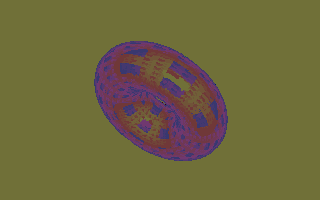

Do the same thing happen if you run one of the little wonders from http://www.256b.com/ in full screen mode from the XP CMD.EXE ??
Try this one: http://www.256b.com/download/375

DosFreak - I specifically said "in full screen mode from the XP CMD.EXE", so DOSBox should not be a factor.
On my system, I get a nice rotating, purple/orange torroid on a greenish background with both XP/CMD.EXE and DOSBox.
If Netskimmer/Guest gets garbled graphics, then something is(?) wrong with his graphics card/driver - which explains the problem with graphics wraparound in games.

Reply 13 of 20, by Netskimmer
It happens starting in full screen and window. I know it doesn't look too bad from the screen shot but it gets annoying, especially with an animation playing.
