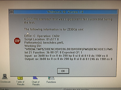

I've found something interesting testing Winbench 96, with the disk mark test. This error does not show up when running from inside an image:
1.03 MiB
2681 views
This suggests that the DOS API is behaving unexpectedly. It looks like it is trying to change directory into a file successfully, which is the same as the issue I was seeing in Windows 1 and 2. It looks like this may fail differently on Windows 3.1, although "could not select drive C" was the error, and there is a SELECT DRIVE dos API command.

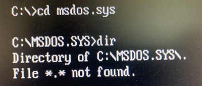

And, to confirm that DOSXbox DOS is not handling changing directory into a file as expected:
177.79 KiB
2681 views
So I may now have what I need to investigate this on the source code side. Hopefully it's not too subtle an issue...

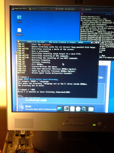

A pic of me just having done that in DosBox on my P200mmx Linux box:

There is no directory called msdos.sys at all. msdos.sys is a file so you cannot cd into it.
The point is that this version of DOSBox is very, very old and has bugs that let you do things you cannot normally do, which consequently affect the functionality of Windows 3.1.
The OP tried to open a file instead of a directory. Simple a that.

The version of DOSBox that I am using (DOSXbox) let me CD into the file MSDOS.SYS. If you look at the command prompt in the screenshot you can see it is reporting the current directory as MSDOS.SYS, which is a file. DOSXbox should not have let me CD into MSDOS.SYS in the first place.
Windows 1 through 3.x were having trouble opening files from open file dialogs for this reason. Apparently, when opening an item from an open file dialog, Windows first attempts to CD into the item, then if the CD operation fails, Windows opens it as a file.
Nobody has noticed this bug in DOSXbox because, yes, it would be dumb to CD into a file. It has only been noticed 15+ years later because of a software issue arising from it.
