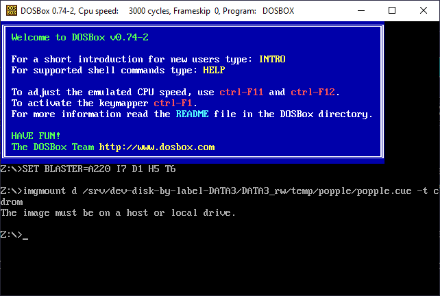

Reply 6 of 13, by darry
jmarsh wrote on 2021-06-29, 23:07:
Make sure the directory holding the bin/cue files is both executable and readable by the current user.
Good to check just in case, but in this specific case, the error suggests that the cue file is being found and read, but the referenced img file isn't .
In the limited tests that I have run, the mscdex error is not shown if the cue file is absent (not there or wrong path) or inaccessible (permissions).

Reply 11 of 13, by darry
jmarsh wrote on 2021-07-01, 06:03:
darry wrote on 2021-07-01, 00:02:
I agree . However, this is likely not the issue in this specific case, as if the cue file and bin/img file are in the same directory and the cue file gets read, but the bin/img file does not, the directory permissions are not the issue . The permissions of the bin/img file could be a problem, but the OP already mentioned checking those (no harm in double-checking).
You apparently missed the part where I said the data files get stat'd. That requires execute permission on the directory. It is not performed on the cue file.
I've been a DOSBox developer for the past three years and have encountered this problem before. Please stop assuming I don't know what I'm talking about.
I am not assuming anything about either this issue or about you . I actually tested it . I also included the output in Dosbox when the mount attempt fails due to lack of execute permission on the folder containing the cue and img files . As you can see, the error is not the one that the OP is reporting . I was running Dosbox's graphical output redireced to an X server running under Windows (Xming) while testing, which explains the Windows-like GUI elements .
After running chmod o+x on /srv/dev-disk-by-label-DATA3/DATA3_rw/temp/popple and starting dosbox and trying to mount cue :
bob@openmediavault:/srv/dev-disk-by-label-DATA3/DATA3_rw/temp$ strace dosbox 2>&1 | egrep "popple.cue|popple.img"
stat("/srv/dev-disk-by-label-DATA3/DATA3_rw/temp/popple/popple.cue", {st_mode=S_IFREG|0664, st_size=769, ...}) = 0
openat(AT_FDCWD, "/srv/dev-disk-by-label-DATA3/DATA3_rw/temp/popple/popple.cue", O_RDONLY) = 10
read(10, "FILE \"popple.img\" BINARY\r\n TRAC"..., 8191) = 769
stat("popple.img", 0x7ffc67456550) = -1 ENOENT (No such file or directory)
stat("/srv/dev-disk-by-label-DATA3/DATA3_rw/temp/popple/popple.img", {st_mode=S_IFREG|0664, st_size=598318224, ...}) = 0
openat(AT_FDCWD, "/srv/dev-disk-by-label-DATA3/DATA3_rw/temp/popple/popple.img", O_RDONLY) = 11
stat("popple.img", 0x7ffc67456600) = -1 ENOENT (No such file or directory)
openat(AT_FDCWD, "/srv/dev-disk-by-label-DATA3/DATA3_rw/temp/popple/popple.img", O_RDONLY) = 12
After running chmod o-x on /srv/dev-disk-by-label-DATA3/DATA3_rw/temp/popple and starting dosbox and trying to mount cue :
stat("/srv/dev-disk-by-label-DATA3/DATA3_rw/temp/popple/popple.cue", 0x7ffcbb26c9b0) = -1 EACCES (Permission denied)
11.3 KiB
1784 views
EDIT: Corrected typo

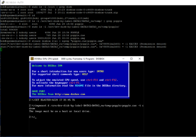

Reply 13 of 13, by darry
DBob wrote on 2021-07-03, 19:26:
Yes, it is. […]
Is SDL_Sound actually found and compiled in?
Yes, it is.
And if, is this SDL_Sound compiled against SDL 1.2x?
I don't know. How can I check it?
EDIT : Also, what distro are you using ? I just tested mounting a CUE/BIN in Dosbox -0.74-2 from Debian repo (version 10.10) and it worked fine for me .
Same here, but without success.
I've made sure earlier the directories are readable, but I had no idea, they have to be executable as well. I just tested it.
It works!
It made me wonder, why this is only an issue for the CUE/BIN mounting only. But for now, I already added modified everything in recursive to be executable. I'll try my other images as well.
Thanks!
Glad it worked .
Execute permissions are required on a directory in order for access to the files contained in it to be allowed . It's still a bit strange that you were hitting the "MSCDEX: Failure: Invalid file or unable to open." error as having "FILE "XEEN1.IMG" BINARY" being set in your cue files implies that that the XEEN1.IMG is in the same directory as the CUE file and if that directory's permissions were not set to allow execution for the user running DOSBox, the CUE file would not have been readable, which would give a different error message .
I tried reproducing the issue that you mentioned using even the latest SVN build, but am unable to do so (see below). So either there is something different between your setup and mine or there is some misunderstanding as to what was occurring on your end.
Without exec permission on directory :
44.65 KiB
1684 views
With exec permission on directory :
55.65 KiB
1684 views
