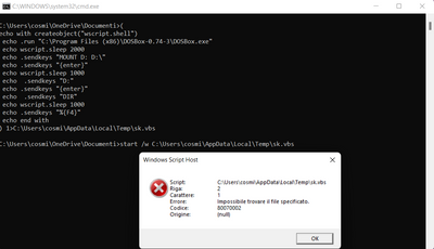

I am trying to create a batch file that run DOSBox.exe, and then send input keys (such that dosbox will think that I pressed a certain key). I created it and it works perfectly with notepad.exe.
My problem is that when I go to change the pathname to open DOSBox.exe instead of notepad.exe, it gives me an error:
ERROR: Cannot find the specified file
ERROR CODE: 80070002
Here the code:
(echo with createobject^("wscript.shell"^)
echo .run "C:\Program Files (x86)\DOSBox-0.74-3\DOSBox.exe" <-------------if i change this with "notepad.exe", it works

    Windows script host error

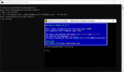

Reply 4 of 7, by Cosmin
Stretch wrote on 2022-03-05, 20:17:
Replacing the 2nd line with the following code may work also […]
echo .run Chr(34) & "C:\Program Files (x86)\DOSBox-0.74-3\DOSBox.exe" & Chr(34)

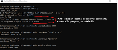

That works! Now it opens DOSBox.exe but does not send input keys. After run DOSBox.exe it stops and does not execute the rest of the commands. Then, if I manually close the tab, the commands continue, and it prints an error like in the photo:
    27.08 KiB
    1018 views
    runs dosbox but does not send any input keys
    31.13 KiB
    1018 views
    the error after closing dosbox tab manually
