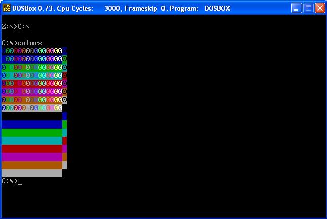

Hi, I am trying to display the 256 colorset usable by the BIOS in DOSBOX 0.73
It works.. but only for half of the colors. The other half is a giant mass of blinking squares. This works anywhere outside of DOSbox. Here's the code.
[org 0100h]
[section .text]
mov bl,01
MAIN:
cmp word [counter],255
je DONE
cmp byte [keep_neat],16
je ENDLINE
mov cx,1
mov al,0
mov ah,9
int 10h
mov dx,blank
call WRITE
inc bl
inc byte [keep_neat]
inc word [counter]
jmp MAIN
DONE:
mov ah,4ch
mov al,0
int 21h
WRITE:
mov ah,9
int 21h
ret
ENDLINE:
mov dx,eol
call WRITE
mov byte [keep_neat],0
jmp MAIN
[section .data]
counter dw 0
blank db "0", "$"
keep_neat db 0
eol db 13, 10, "$"
Compiled via NASM16

Windows XP, I don't have a DOS pc to try it on. DOSbox is the only thing that I have found that this error occurs on. I'll take a screenshot if that helps.

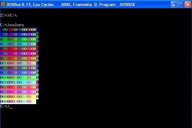

Btw. you can turn off the blinking using an int10 call (al=3, bl=0/1).

My assembly is extremely rusty so I may be completely off base here, but it looks like the problem is you aren't setting the video mode to one capable of 256 colors. On a real dos machine (and DOSBox) by default you'll have a 16 color text mode, so once you go past the first 16 colors you'll run into odd stuff like the same colors only flashing, etc. I believe a dos prompt in XP behaves differently. I think to get this working you would have to explicitly set to something capable of 256 colors by first doing something like:
mov ah, 0
mov al, 13
int 10h

I think the OP meant 256 text color attributes, and wanted to see intense background colors rather than blinking text. The high bit of the attribute can mean either blinking or intense background depending on a bit in one of the video registers, and the BIOS call wd pointed out can toggle it.
Reply 10 of 12, by Goalatio
Confirmed that enabling background intensity allows use of 256 color attributes, thank you sir.
[org 0100h]
[section .text]
mov ax,1003h
mov bl,0
mov bh,0
int 10h
mov bl,01
MAIN:
je DONE
je ENDLINE
mov cx,1
mov al,0
mov ah,9
int 10h
mov dx,blank
call WRITE
inc bl
inc word [counter]
jmp MAIN
DONE:
mov ah,4ch
mov al,0
int 21h
WRITE:
mov ah,9
int 21h
ret
ENDLINE:
mov dx,eol
call WRITE
jmp MAIN
[section .data]
counter dw 0
blank db "0", "$"
keep_neat db 0
eol db 13, 10, "$"
