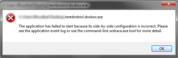

I *tried* to run your DosBox...yet...here's what I got. Dependency Walker produces the same error, but I did see you need MSVCRT90D.dll.
Are you compiling a Debug version?
It turns out that I was, which is why the executable was 1MB larger than the old executable. I misinterpreted the last step of the instructions three times before I finally got it right. I have posted the non-stuttering executable I built, using the latest SVN available. Thanks for all your help!
