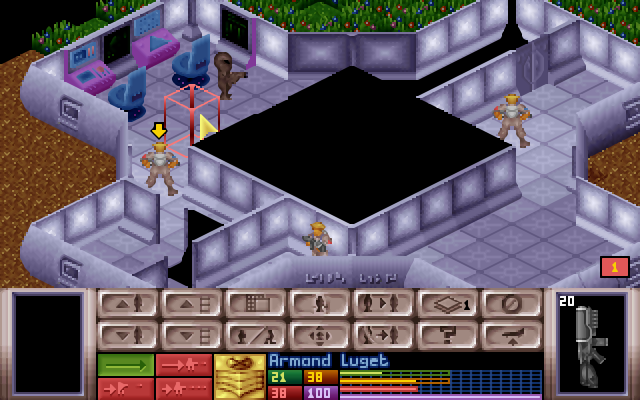

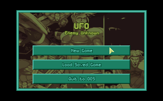

Here are two screenshots from X-Com with hq2x scaler.
Note that the triger value is configurable, thus the same screen can look quite a bit different - this is a trigger value of around 16, I usually run ufo at 65 - it depends on the game and your preference what looks best.
    13.62 KiB
    5031 views
    a combat scene
    62.87 KiB
    5037 views
    some text and buttons (hq2x)
    7.94 KiB
    5037 views
    some text and buttons (normal)
    136.27 KiB
    5037 views
    combat scene with lots of straight edges and smooth areas, also showing the limits of hq2x's smartness
