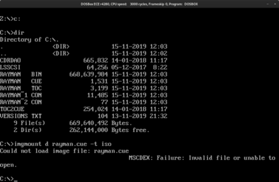

Reply 843 of 1550, by legluondunet
Hello,
I have problem to mount .cue file with last Dosbox-ece version. It worked ok with older version but now I can no more mount .cue file.
I compiled debug version but I obtained no more info.
I need help, it's a very troublesome issue.

Reply 845 of 1550, by legluondunet
Thank you for your answer, as I said it worked with older versions and dosbox is not case sensitive on Linux.
The error message is not "I can not find image or files" but "unable to open".
Reply 848 of 1550, by dreamer_
legluondunet wrote:
@pantercat: I just verified case, everything is correct.
More info: I can mount .bin files, .iso, but not .cue files.
I've implemented an automatic "cue fixer" in Boxtron to work around broken (or simply Windows-only) .cue files provided by game publishers. You can either try it yourself or simply attach a .cue file, a .conf file used for running the game, and output of tree command from game installation dir - that should be enough for me to "unbreak" the .cue file.

Reply 852 of 1550, by legluondunet
I verified case possibility, I verified / and \...even if I didn't need to verify because it worked with older version.

Reply 856 of 1550, by Dagar

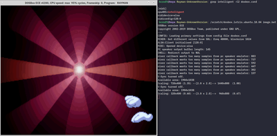

Reply 858 of 1550, by legluondunet
First, I want to say you all thank you for your numerous and very pertinent answers.
I think I found the reason CD cue did not mount anymore with Dosbox ECE on my computer:
in all my Dosbox config files, I have set midi like this:
[midi]
mpu401=intelligent
mididevice=default
midiconfig=
Until recently this config, I didn't even remenber where I found this settings, it just worked.
But now this midi settings avoid my cue files to mount...don't ask me why as I don't see the link between midi and mount cdrom...
A member of this forum sent me his config file for Rayman and all worked as expected on my computer.
The only difference was the midi settings:
[midi]
mididevice=none
All others DOS cue games that didn't launch anymore with Dosbox ECE work now I changed the midi settings mididevice to "none"...
Reply 859 of 1550, by krcroft
legluondunet, happy to hear that knocking out MIDI solves this!
Unfortunately I suspect there something else at play, likely specific to your environment.
This is the first report that ECE requires mass-disabling of midi in order to mount CDROM images (if this issue was specific to ECE or SVN, we would have seen a flood of reports).
Second, I've re-added midi to my config and the game continues to play, and we're both running the same binary and Ubuntu 19.04.
In the meantime, you're up and running! Interested to hear more though, especially if you can get to the bottom of it.
