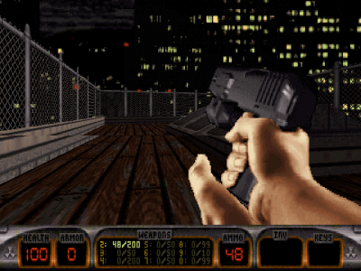

Reply 926 of 1522, by XxMiltenXx
@Ant_222 @Kinsie
The tearing issue only occurs when machine is set to vesa_nolfb. If I use vesa_nolfb it tears even when I use the internal DOSBox video recording. It doesn't matter if V-Sync is enabled or not. If I enable V-Sync (and borderless fullscreen is disabled) I do get the message in my DOSBox terminal that V-Sync is correctly enabled, but it still tears with vesa_noflb:
132.76 KiB
1977 views
When set to svga_s3 it doesn't tear. However, for Duke Nukem 3D (and VESA resolutions) I cannot use svga_s3 as the HUD weapon sprites will sometimes flicker/vanish., This does not happen in with vesa_noflb:

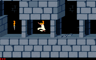

Prince of Persia 1 has the same issue, however, there it is set to svga_s3. It even tears with using DOSBox' internal video recording:
6.32 KiB
1973 views

Reply 929 of 1522, by Ant_222
XxMiltenXx wrote on 2020-01-13, 19:05:
Does it tear only with the outputs introduced my patch, or with other outputs too?
You mean openglpp output with glfullvsync in fullscreen mode, right? Have you tried surfacepp with fulldouble in fullscreen?
If reproducible in stock DOSBox with openglnb, this sounds like a bug worth the attention of the developers...
In stock unmodified DOSBox with openglnb, too? Then I suggest that you report this behavior in a separate thread.
If, on the other hand, these problems appear in ECE only, then I must have broken something.
Reply 930 of 1522, by XxMiltenXx
Ant_222 wrote on 2020-01-13, 20:44:
It happens with openglnb too as well as with surfacepp with fulldouble. Since DosFreak's fix worked, I think it's an engine issue. Specifically with the Build engine.
I tested Prince of Persia 1 with DOSBox 0.74-3 and there it tears as well. So it's an issue with DOSBox, not yours. I will see that I contact them. However, it might also be an engine issue like with Build games, but a different one.
Reply 931 of 1522, by DosFreak
I wouldn't say it's a DOSBox issue rather a game issue. It can be hacked around in certain cases for some games either via TSR or with a patch for DOSBox.
The flicker issue with the build engine is a game issue. Back in the day we used SDD to disable the LFB due to game issues so that's why the setting is in DOSBox.
The official version of DOSBox does attempt vsync, make sure doublebuffer is set to true which may work in some cases.
NOLFB was created by Ken Silverman since games that used Vesa 2.0 has issues with 2000 and above NTVDM so if the game had a fallback to 1.2 then NOLFB got them working but it also works in DOS as well.
NOLFBLIM was created since when NOLFB does the fallback to 1.2 then no more vsync.
