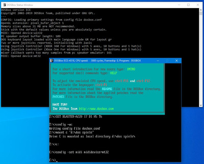

The Munt emulation in ECE is not working for me anymore. It sounds like it cannot find the ROMs, even though they are present in the specified romdir and the ROMs work with earlier versions. I also noticed that if the ROMs are not present in the specified location it no longer tells you "MT32: Control ROM file not found"
The Sierra Help Pages -- New Sierra Game Installers -- Sierra Game Patches -- New Non-Sierra Game Installers
Reply 966 of 1550, by Yesterplay80
collector wrote on 2020-02-10, 19:55:
Which OS are you on? It works for me here under Windows, if I change the rom path it also shows it can't find them.

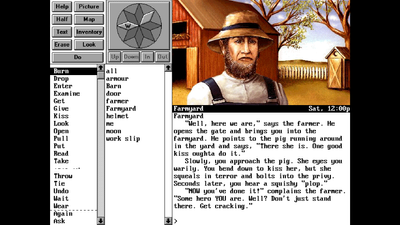

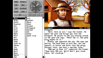

So i tried sharp shader and it looks..pretty bad? And since pixel perfect patch is no longer supported - 😫
Scratch that - i was using openglnb instead of opengl output!
212.75 KiB
2786 views
544.8 KiB
2785 views
Reply 974 of 1550, by James-F
Yes, it is glorious.
The higher you native resolution of your display, the sharper the image will look.
When the upscaling factor is big (say from 320x200 to 1080p) the sharper the image will look with less and less blur, and accurate pixel geometry.
There is no modern emulator with low resolution like SNES, Genesis, NES etc.. that does not have this filter.

Reply 976 of 1550, by collector
OK, the problem is that I was not changing mididevice from default. Other Munt builds and I could have sworn earlier ECE builds did not need this.

Reply 978 of 1550, by Yesterplay80
collector wrote on 2020-02-11, 14:55:
Yes, the first few ECE builds including MT32emu had it set as default, you're right. But I already changed that quite some time ago, because MT32 isn't supported by all games and I thought it better to have a midi device as default that works with every game.

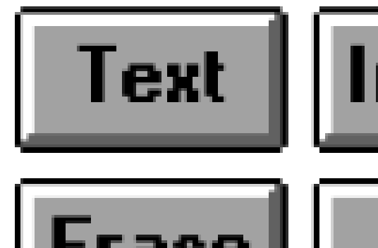

It's a huge improvement - finally no pixel size inconsistencies. Thank you for jmarsh and ny00123!
OpenGL expectedly needs to blur the shaders' pixel edges to fit the rendering surface (image attached below). So can it get even better? Pixel-Perfect Shaders, assuming an even-integer multiple (either up or down) can be found between the shaders' output and the rendering surface. Indeed, ant-222 is busy working on Pixel-Perfect once again.
For native DOS output, PP doesn't need shaders; so it's the visual re-interpretations offered by shaders where PP can help eliminate pixel blur by adjusting the rendering size.
Yesterplay80, I also share your sentiment regarding the voodoo patch: an unfortunate but unavoidable consequence of unaccepted patches that touch the same area changed by upstream. Hopefully that patch author can refurbish it again or someone else can take up work.
With 4k displays, I can easily see all three coming into play: Voodoo emulation @480p ==> GSL shaders (say, applying a Sony Trinitron RGB color adjustment and curvature) @960p ==> Pixel Perfect rendering size adjustment to 2160x1920 on 1440p and 4k displays.
