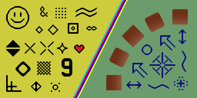

In file src/gui/render_templates_hq.h (in function diffYUV) the lines 44, 49, 54 are the same and look like this:
mask = diff >> 31; // -1 if value < 0, 0 otherwise
Since diff is an unsigned integer, the result won't be -1 if value < 0, but the result will be 1.
To get the correct result, the lines should to be modified to look like this:
mask = ((Bit32s)diff) >> 31; // -1 if value < 0, 0 otherwise
Reply 1 of 3, by M-HT

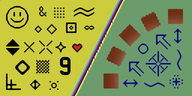

An example image scaled with hq3x using unfixed code:
7.19 KiB
600 views
An example image scaled with hq3x using fixed code:
8.14 KiB
600 views

Both diff and mask are both unsigned. So we are dealing with ~1 internally. Let me update the comment as well.
Commited in 4198
