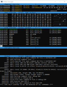

Reply 159 of 160, by llm
the BPM (breakpoint on memory change) feature seems not to work when using F10 (only with F5) - or do i use it the wrong way?
long time dosbox debugger user but never used BPM before
in src\platform\visualc\config.h
#define C_DEBUG 1
#define C_HEAVY_DEBUG 1
in dosbox-SVN.conf
[cpu]
core = normal
current SVN build with VS2022 and latest third party source builds using vcpkg
my nasm test program bpm.asm
; nasm -f bin bpm.asm -o bpm.com
org 100h
mov byte [var],1
mov byte [var],2
mov byte [var],3
mov ax,4C00h
int 21h
var db 0ffh
the breakpoint only hits after program end
what i try
1. in dosbox: debug bpm.com
2. set data view to ds:114 - the variable with the start value 0xFF
3. set a BPM to ds:114
4. step through the 1,2,3 assign - nothing happens
5. at the end a breakpoint hit?
218.78 KiB
2196 views
see what happens
shouldn't the breakpoint hit on every [var] mov - or is it a feature that is does not break on F10?
