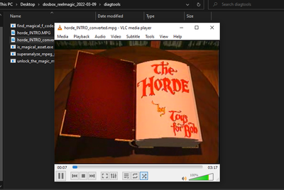

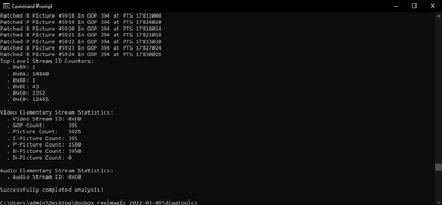

Update: I have created a new release for this: https://github.com/jrdennisoss/dosboxrm/relea … /tag/2022-03-05
  • "The Horde" video should now play reasonably well.
  • MPEG tools have also been updated to be able to convert "The Horde" videos to standard MPEG-1 format.
The workaround I am using is getting even more complex, however I decided to put it in anyways because it allows further testing of games.
Bobbytoz
Now an original copy of "The Horde" should play reasonably well in the emulator. I have not completely tested it, but randomly playing some files in SPLAYER.EXE as well as watching the game opening seems to work now. You will still see the macroblock/block boundaries you mentioned before, however video quality for the most part should be good. I created a ticket to track finding a smoothing solution for this so I don't loose sight of it: https://github.com/jrdennisoss/dosboxrm/issues/41
With regards to your goal of creating a patched version of The Horde CD having "clean" MPEG video assets, there is a Linux tool that I included in the repo that will do what you want; the "unlock_the_magic_mpeg_ps" program in the "tools/" directory. This is a 100% lossless conversion as all it does is correct the sequence frame rate code and P/B picture f_code values so that the new file will be playable on MPEG-1 compliant decoders/players. For The Horde, it looks like these MPEG files were encoded with an f_code value of 4, but you can use the "find_magical_f_code" tool to confirm. I haven't analyzed all of them, but just a handful this was true. This is all documented in the "NOTES_MPEG.md" file, but the gist of it is:

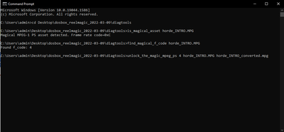

First hit 'make' in the "tools/" directory on a Linux machine to build all the MPEG tools in the repo.
Then, find the "magical" f_code. For example:
$ ./find_magical_f_code ../hordecd/INTRO.MPG
Found f_code: 4
Finally, patch the video using the found f_code of 4. For example:
$ ./unlock_the_magic_mpeg_ps 4 ../hordecd/INTRO.MPG INTRO_WORKING.MPG
That will create a new MPEG-1 compliant file called "INTRO_WORKING.MPG" and you should be able to open this new file in your favorite player (e.g. VLC, Windows Media Player, QuickTime) and the file should play without issue. 😀

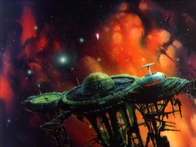

I have also checked "Space Ace", as it had the same artifacts in videos as "The Horde" did. The videos are fine now there too, but the game still plays incorrectly - skipping many scenes and not responding to pressing the keys.
And "Entity" still shows artifacts.

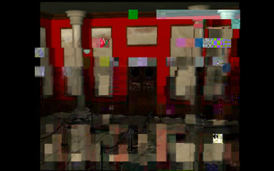

The Horde RM MPEG CD:
- It starts (GamePlay playable)
- Magical MPEG works (Rare image artifacts slip through)
- Sound artifacts appeared (Crackling, clicking)
- Exiting the game while playing a video (Intro 100%)
- After the video is black screen, you need to press the actions button to continue (Not as original)
In any case, the progress is great!

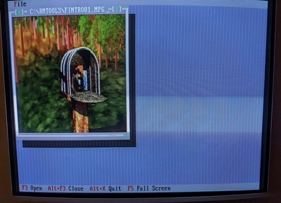

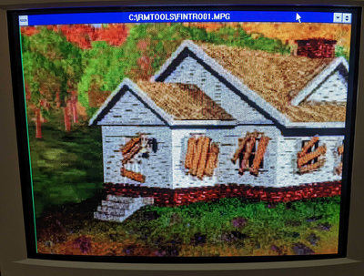

OK, here is my first system: the original ReelMagic Lite (with feature connector) and drivers version 2.21 (not 2.01 - I forgot I have already upgraded that).
Tests 01-04 - everything is fine!
Tests 05-06 - the video plays fine, but then the system freezes on its last frame. No LOG files (they are 0 bytes).

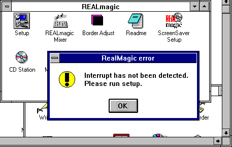

Tests 07-09 - the video does not play! The system freezes with a message that the driver is already installed. There are LOG files though.
Test 10 - everything is fine, except that the video pauses for a second in the middle.
Test 11 - the sound plays fine, but only a small part of the video is seen, and after playing the system freezes with a message that the driver is already installed.
It would take more time for me to test the system with Maxima, especially when rebooting after each test 😀

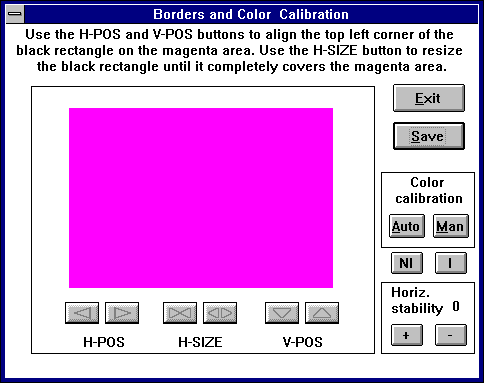

Can I help you with anything here? What messages do you get? Have you calibrated the video?

Or maybe there is no real difference - the results are very similar to those of ReelMagic Lite.
Test 05 - the video plays fine, but then the system freezes on its last frame. No LOG file (0 bytes).
Test 06 - the video plays fine, but then the system reboots instead of freezing! No LOG file (0 bytes).
Tests 07-09 - the video does not play! The system freezes with a black screen and no messages. There are no LOG files (0 bytes).
Test 11 - the sound plays fine, but only a small part of the video is seen, and after playing the system reboots. No LOG file (0 bytes).

However, the calibration does not run in Windows. (attached photos below) Video does not play in DOS using the same probe tests (01-04) nor in TESTFMP.EXE using "C:\SIGLOGO.MPG" instead of of CD-ROM. The card does seem to respond properly at port address 260h, however I have not yet confirmed if DMA is actually working as this might be the source of our problems. The screen does go black so that tells me that the ReelMagic card is physically installed correctly and able to intercept the VGA signal.
Oh, that looks like some IRQ/DMA conflict. Sadly that happens on later (Pentium) systems. I had to fiddle with BIOS manually setting "Legacy" ISA for the ReelMagic Maxima to work with the sound card. What Address/IRQ/DMA you chose when installing the drivers in Windows 3.11?

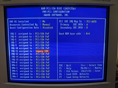

Yup that was it! We switched on the "Legacy ISA" setting in the BIOS for the board's IRQ slot and things now work in both Win3.11 and DOS!!! (pics below) Thanks for the suggestion! 😀

Update: I have created a new release for this: https://github.com/jrdennisoss/dosboxrm/relea … /tag/2022-03-09
  • Windows binaries for the MPEG diagnostic tools are now included in the "diagtools" folder.

for windows10 x64?
This turned out to be a pretty quick and simple update. I ran a quick test on my Windows 10 box with The Horde intro video just to make sure it works correctly. The conversion of the file took about 30-45 seconds. Let me know if you have any questions! 😀
