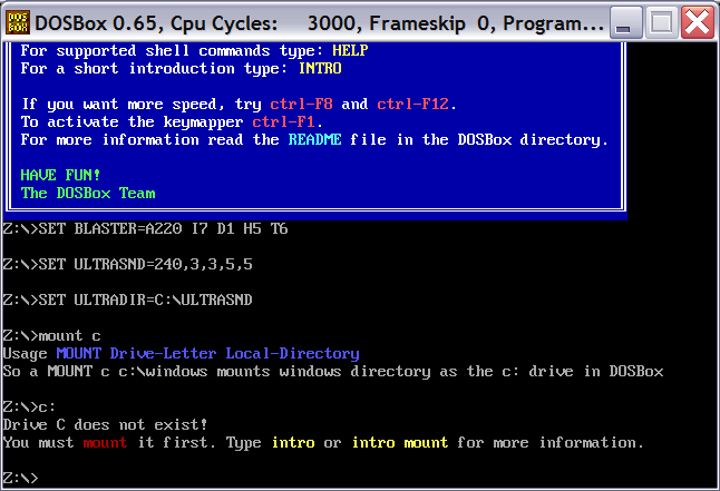

ok..iv installed the game on my hard drive as well as dosbox. first thing, i cant change z:\ to c:\ on the dosbox command prompt even after checking out the faq's and using the mount command. the reply when i do this is "usage mount drive-letter local-drectory so a mount c c:\windows directory as the c: drive in dosbox" which doesnt mean anything to me. also, iv tried to run the game in the windows command prompt and the screen will go black for a minute and then return to windows as if iv dine nothing.

ok new problem..... i got the z:\ to c:\ and got the prompt to go to C:\WESTWOOD\ but when i enter the KYRACD command (as the intallation process told me to use) i get "unable to load font 8FAT.FNT reinstall program" even though i did reinstall it. im stumped.

dreads311 wrote:
#2: in dosbox cmd prompt, typed "mount c". enter. typed "c:" enter.
That is strange. When I start DOSBox 0.65 and type "mount c" I get an error message???
And the "c:" also results in an error message.
Do you have a magic version of DOSBox that automagically correct your errors?
    22.83 KiB
    1323 views
    Error message from mount command

No matter what they say above me, you obviously got Dosbox to work and you are able to mount something as c.
But whatever you are doing, you are making a big mistake with this:
#4: inserted cd. "start", "run", typed "e:\windows\wininst.exe" with e: being my cdrom drive and followed installation prompts. (should it be c:\windows\wininst.exe?). also went through the SETUP prompts after install.
You are using Dosbox to emulate Dos not windows. so do as lofty says and mount your CD-Rom drive in Dosbox as well (mount d e:\)
then change dir to d: (in dosbox with the mount command I wrote, d: is now your CD-Rom drive e:) and then type install or setup and it should do something 😀
To recap, my suggestion is to type the following in Dosbox (followed by a return):
mount c c:\westwood
mount d e:\
e:
setup (or install)
This assumes you have a folder on your C: Drive called Westwood. In the install program let it install to c:\ and whatever program name it wants (C:\Kyrandia perhaps - on your real drive this would be then in c:\westwood\kyrandia)

Erm... this is pretty obvious. You're typing "mount c", which is not a complete command. The error message tells you exactly what you need to do: type "mount", followed by a drive letter, followed by the name of a local directory (that you wish to mount). So to mount "C:\Windows" as your C-drive, type "mount c c:\windows". To mount your real C-drive as your simulated C-drive (which isn't recommended), type "mount c c:\".
That is what MiniMax is trying to tell you.
To mount your real CD drive E: as the simulated CD drive D:, type "mount d e:\ -t cdrom".
