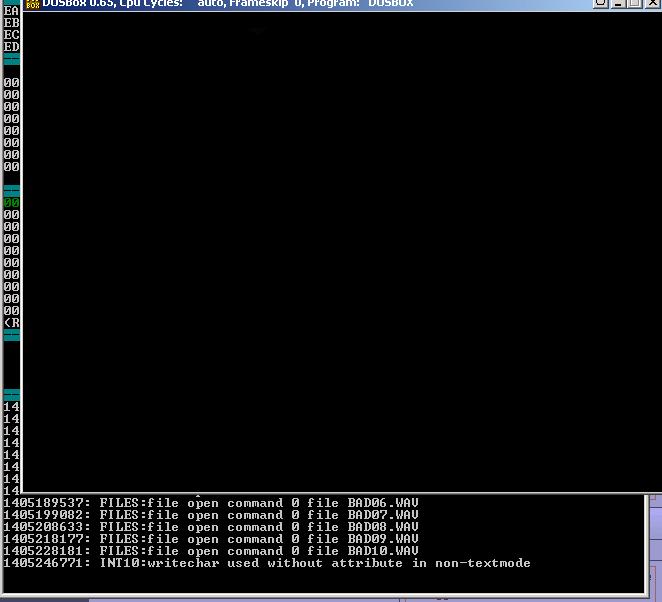

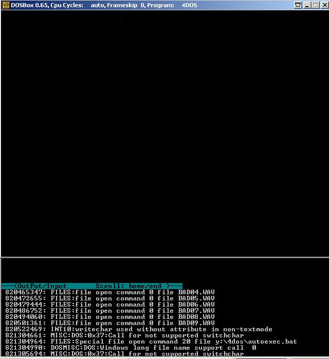

One of the games I'm having some problems with is Dungeon Keeper's installer.
The installer works up to the point when it starts copying files to the HD. The installer reads the CD-Rom, creates three directories under the Keeper directory. Then it gets stuck with a black screen.
I tried it with both the normal and the dynamic core.
Also tried running the setup using the 4DOS command extender.
The Soundcard configuration and test work both for the SoundBlaster 16 and the Gravis Ultrasound.
Running the setup in DOSBox 0.65 has the same result.
Running the setup in the debug version without 4DOS results in a
INT10:writechar used without attribute in non-textmode
Running the setup in the debug version with 4DOS results in a
and a
MISC : DOS : 0x37 Call for not supported switchchar
I'm going to copy the files manually and start from there.

    Some other thing that popped up using the Debugger.

    Using Dungeon Keeper with 4DOS in the debugger.

    USing Dungeon Keeper without 4DOS in the debugger.

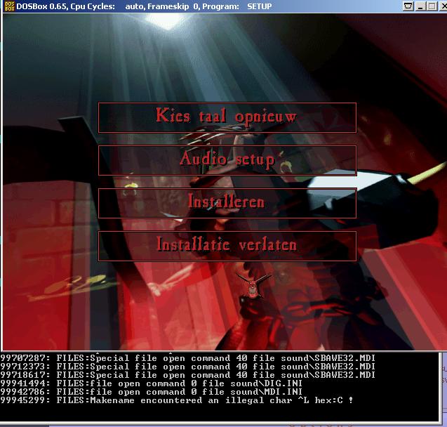

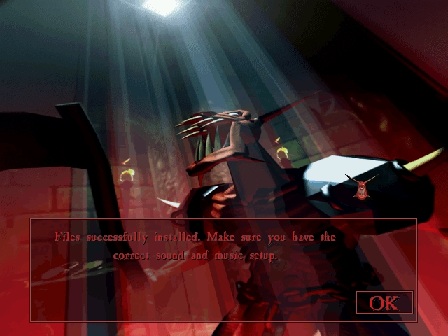

Reply 2 of 18, by ErikGG
Strangely enough the English install works for me too, 2 times already under 0.65 debug, did crash once too though... ???
I'll try out the other install languages.
Up till now the dutch manual install works wonderfully only that the sound get scratchy after a while, but this must be my system being too slow. (Using the SB16 configuration)
Anyways will report back.
Erik.

Reply 9 of 18, by Qbix
Rank DOSBox Author
DOSBox Author
that makename error in the debug screen behind the dutch red screen is interresting.
