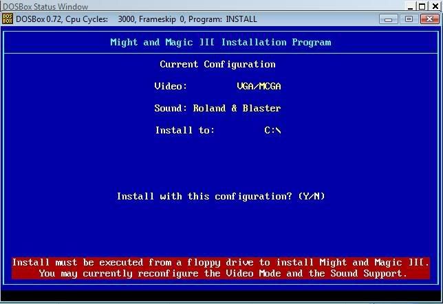

I've looked high and low and can't seem to find anything that adresses this problem, and I've come to the conclusion that I'm doing something really dumb. Problem is, I don't know what it is!
Running DOSBox 0.72 on Vista.
I have MM3 on a floppy - problem is my usable computer doesn't have a floppy drive, so - I was able to get MM3 onto a flash drive (using a half-dead computer) and thus into this one. Everything fine, looks ok in DOSBox but it won't install, it wants to be installed from a floppy! Here's a picture of the screen I get:
No doubt its something really simple and I'm too far inside of it to see!

Z:\>mount C C:\Deb\DOSBoxstuff\Mydosgames
Z:\>mount E E:\ -t cdrom -ioctl
Z:\>C:
Then I went into Mydosgames and into the MM3 directory, and typed "install".

No, use -t floppy instead of -t cdrom so the installer sees it as a diskette:
Z:\>mount A E:\ -t floppy
Z:\>mount C "C:\Deb\DOSBoxstuff\Mydosgames"
Z:\>A:
A:\>install

Wait - the game is actually on my C drive, though, in the Mydosgames folder, not on a disc in my cdrom drive, so that is not working. Hmmm, maybe if I return it to my flash drive and then mount that as A?

wd wrote:
You said you want to INSTALL it. Where are the installation files?
Mount that directory as a: (like mount a k:\here_is_the_installation -t floppy)
Got it! Moved the files back onto my flash drive and mounted that as A:
I have the game on floppy, the big problem was in not having a floppy drive on the computer I'm using. My other computer with a floppy drive is on the verge of a breakdown. So I had to use that to move the files from floppy to flash and from flash I had moved it to the Mydosgames folder on my C: drive...dizzy yet? 😀
Anyway, moved it back, mounted my flash drive as A: and it worked.
Thank you!

You don't need to use your flash-stick. You could have created a C:\Deb\DOSBoxstuff\Fakefloppy folder, copied the files there, and mounted it as:
mount A "C:\Deb\DOSBoxstuff\Fakefloppy" -t floppy
The only difference to my little guide (that is using a CD as drive D), is that you will use a fake floppy as drive A.
