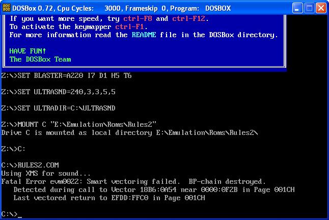

Greetings. I have been trying to start this game with dos box for the whole night with no success and hope some of you may be able to help out. I think there may be a memory setting / sound issues and I have search this forum and googled for help and have no success. I used Dfend as front end and my system is AMD p4 2.6 Ghz 3G RAM.
If I config soundblaster, it will have an error "fatal error evm002..." (see attached jpeg). If use loadfix 20k with SB, it will start but will still crash in game. If I config with any drivers other than soundblaster/MT/Adlib, the game will say no xms / ems will load and the game will start but will crash again when I start the campaign with an error message "not enough memory" I tried dynamic / normal / simple core but does not help. Dynamic seems to allow the game to run further but will still game short after the game start. Here my config file:
    55.77 KiB
    2454 views

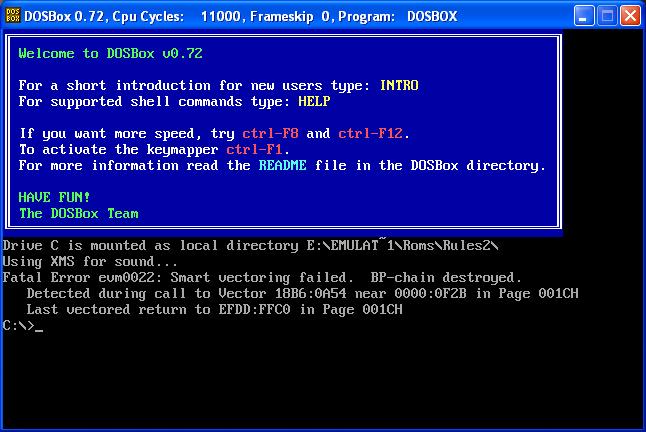

Tried removing keyb 437 line in the autoexec but the game will not run.The same error persisted as the attached jpeg in my first post.
Loadfix 64k get to the main menu screen but it flashes and closed automatically out of dosbox. Do you have any idea? This is the spec of the game per mobygames:
Minimum CPU Class Required 80286

Just dug up my big box copy and tried it out. No luck. Same error for version 1.08. For some reason, version 1.07 works fine. I have attached again for the error I encountered.
    56.56 KiB
    2354 views
