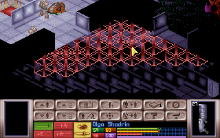

I am playing XCOM 1 with Dosbox v.72 and Windows XP everything was going great and things were working fine until I entered my first Alien base at which time the screen starts tearing horribly and makes the game essentially unplayable.
I tried switching from full screen to windowed and adjusting some of the settings in my Config but nothing I have did as of yet has helped in the least bit. In case it matters I believe I am playing version 1.2 of XCOM 1.
I also searched the forums, and Googled it along with trying various other settings in my Config and nothing seems to help. If I was to guess I think it may be somehow related to my config settings or my LCD not liking the new resolution.
I started to post my Config file and a screenshot here but I decided that might just cause this thread to get cluttered for no reason but if you think it might help I will be happy to do so.
Either way whatever it is I seem to not be able to figure it out any help would be appreciated. Thanks.

a screenshot will be handy. (as if it does show on the screenshot then your lcd has nothing to do with it. (be sure to make the screenshot with ctrl-f5)

Here is the screenshot it seems I was wrong then (no surprise) and it is not my LCD.

Reply 4 of 19, by Qbix
Rank DOSBox Author
DOSBox Author
can you post the contents of your dosbox.conf ?
I would suggest core=dynamic cycles=10000
but to give a good suggestion I need your system specs

Reply 6 of 19, by Qbix
Rank DOSBox Author
DOSBox Author
the only thing I can recommend from this is to set the memsize back to it's original value or maybe even lower it to 8
xcom doesn't need much memory.
Isn't there a 1.4 patch for this game
i take it happends as well with the normal2x scaler ?

Reply 7 of 19, by Kingjames
Set memsize back to orginal - no change
Yes there is a 1.4 patch but it seems to bork the sound, I have no idea why.
It happens with the normal2X scaler, it also happens with scaler set to none.
Reply 8 of 19, by wd
Rank DOSBox Author
DOSBox Author
Looks like a game bug (maybe caused by dosbox though), check the sound
configuration and installation (mount c c:\ufo doesn't look like you've done
a correct installation).
Maybe try to use loadfix before starting ufo.

Reply 14 of 19, by wd
Rank DOSBox Author
DOSBox Author
In this case I merely copied all the XCOM 1 files to the hard drive and ran the "Setup".
Don't know if this qualifies as "properly installed".
Anyways try the loadfix stuff and/or check if it behaves the same with sound
disabled, and see if it might just be a corrupt savegame or so.

I seem to recall having this issue back in the mid-90s so I don't think it's a DOSBox issue. Unfortunately, I do not remember what the solution is.
I later bought the CD version and it's working fine for me in DOSBox.
