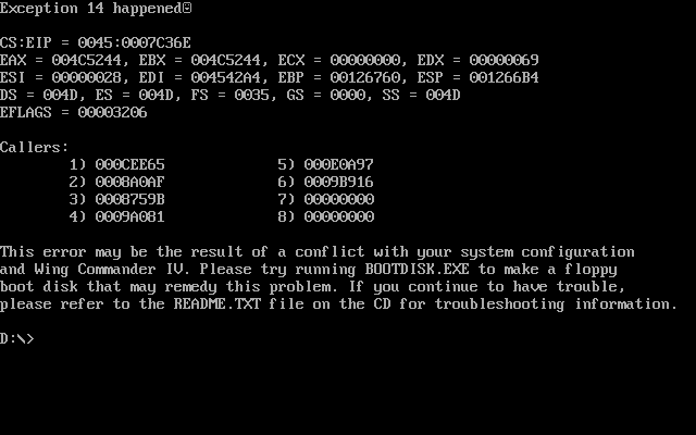

I found this one:
http://download.wcnews.com/files/wing4/wc4demofull.zip
It plays the intro video, then it crashes back to DOS ("Exception 14 happened", followed by a lengthy error code). Hmm...

Xelasarg wrote:
I found this one:
Confirmed.

With core=normal, DOSBox dies after the intro.
Tried different cputype's. Did not make it work. Either the same crash, or total abort.
Choosing no sound card in SETUP makes no difference.
Solution: ems=false

Reply 10 of 18, by Xelasarg
Works for me too. Damn, should have thought of Origin's crappy memory management in the first place...
