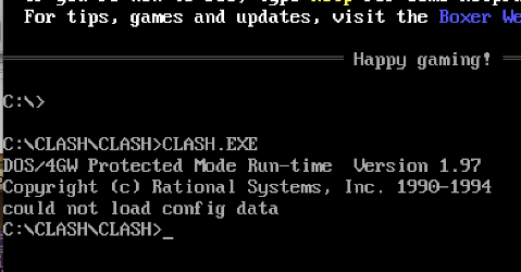

Lately I found the great opportunity to play my lovely old dos games on my Mac! Games like Keen or SkyRoads are working fine, but there's a strategy game called Clash (by Longsoft / Software 2000) which I can't play or start at all. 😖
It says "could not load config data" and that's it.
(I added a screenshot of it.)
I have really no idea what kind of data that is... I'm really new to this DOS emulating system.
Can anyone help me out? I don't know what to do. 😒
Thanks in advance!! 😀

Reply 1 of 6, by DosFreak
Looks like the mounting may be wrong if so the game would be looking in the wrong place for the config.
Are you sure the game goes in C:\Crash\Crash if it is installed from the original disks?

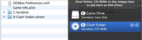

Reply 2 of 6, by max-seb
I really appreciate your support DosFreak!!
Well, I have the data on my harddisk instead of a CD.
May it solve the problem, if I burn the data (which is normally on a CD) onto a CD?
The game is installed in the folder "C.harddisk". The CD (which isn't actually a CD, just another folder on my hd) is in the folder "D Clash Folder.cdrom". So how can I tell the program to use the .cdrom-folder? Is there any command to type in?
Or... how can I check which folder or files the program uses to start up? Or maybe any other commands I could try?

Reply 3 of 6, by max-seb
I just added another screenshot. I think the mounting is okay. Maybe, the program can't find a config data within the .cdrom-folder? But where to get a config data out of nowhere!? 😒
(I could be completely wrong. I don't know. )
Reply 4 of 6, by dada
You're really gonna have to give us more information on what's going wrong.
A mounted CD drive is different from a mounted HD drive.
Try the following mount commands:
mount c "C.harddisk"
mount d -t cdrom "D Clash Folder.cdrom"
Maybe you need to run setup/setsound or something like that before you can run the game itself.
Reply 5 of 6, by kolano
There should be a file "CLASH.CFG" in the "longsoft\clash" folder (or "clash/clash" I guess in your install). It's created by the "setup.exe" installer on the CD during it's last step when a sound card is selected. Both the game, and post install setup will fail as described with that file missing.
Reply 6 of 6, by Dominus
Rank DOSBox Moderator
DOSBox Moderator
you are using Boxer and thus you should ask Boxer for help.
