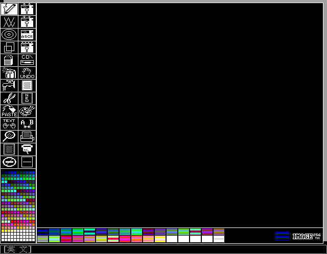

Is there anyone know the IMAGE256 of A4tech ?
http://www.helpdrivers.com/scanners/A4Tech/Image256/
It is a great graphics edit program.
But can't run in DOSBOX 0.74.
Anyone can help me ?

Reply 2 of 5, by coolhaken
No no no ....
Please take a look at the URL I wrote.
It is exactly a DOS program and I have the A4 scanner.
You can decompress image256.exe by WinRAR.
I remember It runs without connecting the scanner.
(maybe different version ?)
But this program shows main screen then hangs in DOSBOX 0.74 ...

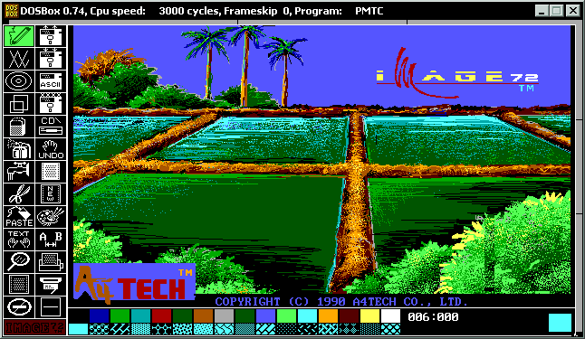

Reply 3 of 5, by Joey_sw
try the older version Image72, but thats only support 16 color.
it has 4 version:
for hercules graphics,
for monochome ega,
for ega (16 selectable from 64 colors),
and for vga (16 from 262,144 possible colors)
thats version definetly for DOS, as i remember running that program on XT machine with 256K-VGA.
and i have no scanner at that time too.
the manual for that program contain a somewhat NSFW image.
UPDATE:
finally found Image72, except for the hercules version,
its turn out that it also runs just fine under WinXP (x86),
dosbox doesn't really needed, unless you're using x64 windows....

Reply 4 of 5, by ripsaw8080
Rank DOSBox Author
DOSBox Author
The app has a bug that occurs when DOS reports more than 11 valid drive letters via INT 21/0E. DOSBox reports 26 drives because of the Z: drive, but the bug would also occur in real DOS if LASTDRIVE= in CONFIG.SYS is higher than K.
Put the attached workaround program in the app folder and run it to start the app; it changes the reported drives to the maximum safe number of 11. You will also need ETen 2.x installed somewhere that the app can find it, and DOSBox settings of ems=true and machine=svga_et3000 or machine=svga_et4000.
    A4FIX.ZIP
