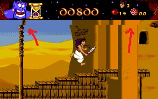

Since this problem only occur in Aladdin in dosbox 0.74
while its game cousins Lionking and Jungle Book from same year are spared
from this
....i wanna test waiting to add my computer spec
(lame excuse 😉 but its hard to gather correct info! atleast)
So can we see first if someone can suspect some settings in dosbox config that COULD possibly make Aladdin to move slow and laggy inside the actual levels only, cause the main menu and load screens have normal speed.
I have tested to change surface to overlay and without result, thats the only thing i find related inside dosbox.config,
But i dont know much so you tell me! 😊

Thanks that was some 😉 increase, however
do you got an alternate value perhaps?.
The slow run is gone the tempo was corrected,
but there is what do you call it? "frame rate" issue
at the top of the screen when im in the air jumping
Im on win 7 by the way

I think i changed V-sync now, bur it didnt remove the annoying lines,
its pretty much of this glitches for it to disturb the gameplay.
I changed to 60000 mhz CPU setting now, thats almost the value of
my old 486, it didnt remove the v-sync glitches.
Perhpas sett even higher than 6000? 66000...
    426.24 KiB
    136 downloads
    Is this the setting? turning to off

Hang on, cycles are not MHz (or kHz). It's not even linear, you can only guess how fast the emulated machine is. 60000 cycles are not 60 MHz, but at least equal to something like a 120 MHz Pentium.
You don't need so much speed for Aladdin, set something around 12000 - 14000 cycles (~386/40 MHz), that should be more than enough. Have you tried changing output=opengl or output=ddraw in your dosbox.conf? Or you could use ykhwong's build (http://ykhwong.x-y.net/), I think it features a vsync option.
"What's a paladin?!"
Reply 16 of 20, by NY00123
On the graphics driver side, the VSync setting should be the one for OpenGL apps (assuming there's any other).
On the DOSBox side, set output=opengl or openglnb.
One warning about VSync, though: If DOSBox takes advantage of a VSync setting like that, slowdowns are expected in some portions of some games. A good example is the title screen fading in Commander Keen 4-6 being *much* slower with VSync turned on.
I am not currently aware of a way to solve the slowdowns while also having proper VSync. So, either you have no severe slowdowns, or you have less tearing, but not both.

Reply 19 of 20, by Kloppstock
I have tested ddraw and all other outputs but it doesnt fix the jump lines.
So if there isnt any other settings left? i suppose the last thing to try is to make sure the added V-sync settings inside
ykhwong's build (http://ykhwong.x-y.net/) are correctly chosen
This didnt fix it so far
[vsync]
# vsyncmode: Synchronize vsync timing to the host display. Requires calibration within dosbox.
# Possible values: off, on, force, host.
# vsyncrate: Vsync rate used if vsync is enabled. Ignored if vsyncmode is set to host (win32).
# Possible values:.
vsyncmode=force
vsyncrate=75
I also wanna know what the ONLY
(it dont call itself for "opengl" longer?)
V-sync setting existing in ATI Catalyst...
(se my attach in my prev post)
...shall be setted to so it cant limit and possible override dosbox
own V-sync settings, perhps these 2 shall even co-operate with eachother?.
My windows/screen resolution
is 60 Hz through 1680X1050 i dont know if this
can ever affect inside dosbox, but i wanna report every possibility
