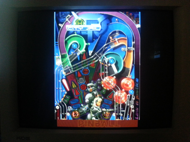

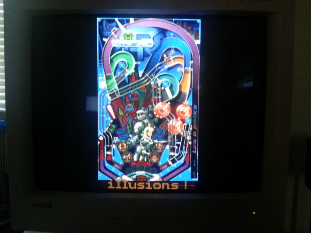

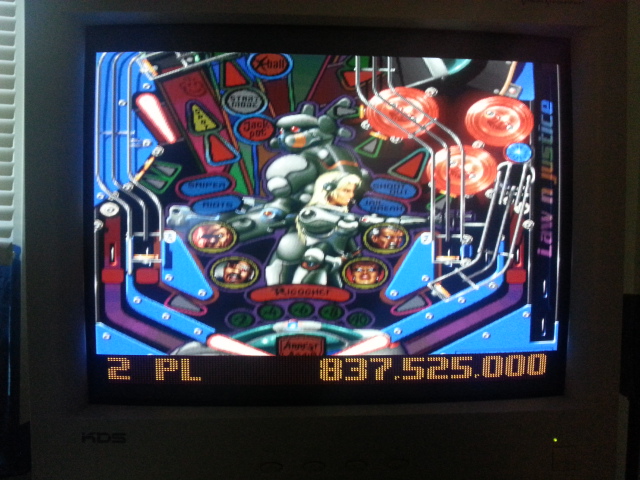

If anyone is interested, here are camera pictures of my CRT VGA monitor running Pinball Illusions at the 360x350, 640x480 and 800x600 modes with the horizontal and vertical size set to the maximum or to the edge of the bezel.
