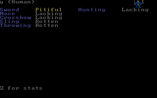

The scrolling problem is fixed now in CVS, thank you for writing that function. There is one minor graphics issue left:
In this screenshot the text should be visible, but the skill names seem to be printed on a background of the same colour. The ratings look mostly okay, I don't have access to real DOS right now so I can't tell if the ones with the background colours are supposed to have them.
Reply 12 of 12, by Harekiet
Rank DOSBox Author
DOSBox Author
Hmm yes annoying, was kinda wondering when this was gonna happen since in mode 0x13 you can't xor characters on the screen using bit 7, but bit 7 is just part of the color 😀
Edit:
Okay that fixed now too i think.
