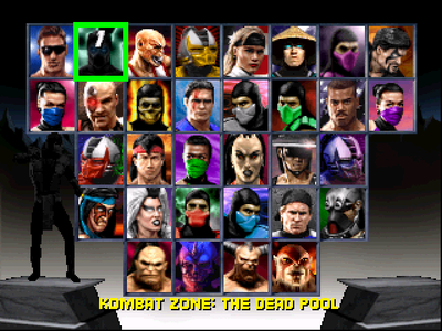

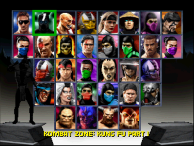

Reply 5 of 21, by Thr1ller
How to make adequate pixel smoothing (to the likeness bilinear.fx shader)? Was it in version Windows? If so, how can i activate it? Thank you for the answers!
For example, two screenshots:
    106.55 KiB
    6796 views
    545.45 KiB
    6796 views
Reply 8 of 21, by Thr1ller
Silanda wrote:
My advice would be to use dgVoodoo 2 for the Windows version. The game should then run at 320x240 and is scaled up, filtering the image. That only works in fullscreen mode though.
Thanks man). Its work!
