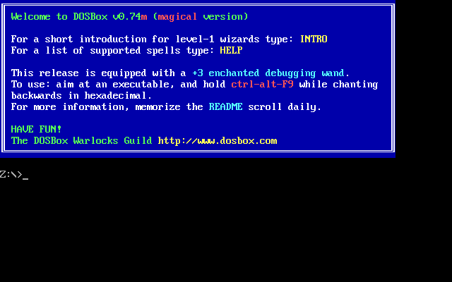

Reply 8 of 16, by exofreeze
In response to your question ripsaw8080, yes I have tried auto cycles, and fixed cycles ranging from low values (2,000) to higher values (stopped at 40,000).
I'm starting to think you have a magical version of dosbox. I am repeatedly running into games that don't work for me that seem to work perfectly well for you 😒
Thanks for your research into this peterferrie.
In this particular case, it sounds like ripsaw must have a different version than we do...

Reply 11 of 16, by VileR
and I thought the magical version wasn't for public release - I guess the jig is up...
    8.93 KiB
    2355 views
Reply 13 of 16, by exofreeze
Sweeeeet, now that I see how this works, I'm interesting in the handjob version.... 🤣
I compared notes with ripsaw on this and indeed, his version of the game was different than my own. Thanks for the fix on this version peterferrie.
