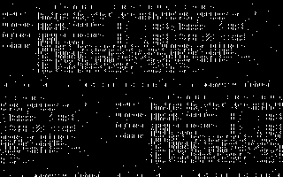

Hi all,
I tried playing the 1985 PC version of Space Wars found here:
[url]http://abandonware.the-frenchkiss.biz/index.p … age=fiche&id=60[/url]
on DosBox, but the graphics are all over the place, everytime I play it. The pixels don't seem to be connecting, so it's like playing join the dots or something.
I have an AMD Sempron 2200+ 1.49GHz, 480 MB RAM.
I tried fiddling aorund with DosBox settings but, see, I'm incredibly stupid when it comes to these things. Help?

Reply 2 of 6, by rcblanke
Hi guys,
Sorry MiniMax, but I believe razblow is right in that Dosbox incorrectly displays the game, no matter what setting. I believe it has to do with the 2-colour cga mode that the game uses (wasn't that "SCREEN 2" in gwbasic?). It isn't implemented yet (in dosbox 0.63) but there seems to be a patch available here http://sourceforge.net/tracker/index.php?func … 551&atid=467234
Kindest regards,
Ronald
Reply 3 of 6, by Qbix
Rank DOSBox Author
DOSBox Author
that patch wasn't entirely correct.
i commited another one which seems to work better.

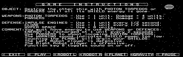

    5.64 KiB
    1030 views
    screenie
Water flows down the stream
Reply 5 of 6, by Qbix
Rank DOSBox Author
DOSBox Author
this was the old one for reference.
So if you had any game that looked like this....
I tested it with:
romance of the middle kingdom 1 (startup question)
Life and Death (title screen)
Spacewar.
    5.56 KiB
    1019 views
    63 screenie
