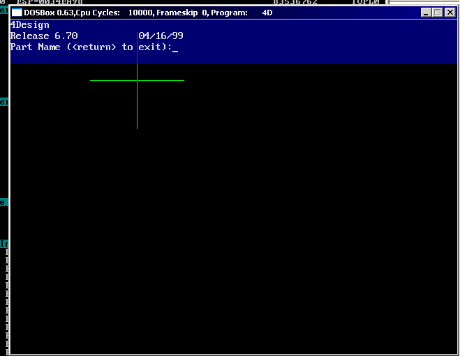

I am trying to run a DOS-based CAD program called 4Design. When I run the program, I get the error "Fortran runtime error on external file "COM2" (2): No such file or directory" in the dosbox window and the error "Warning: file creation failed: currentDirectory\COM2" in the command window.
The file COM2 does not exist in the directory, however, if I try and create it in Windows Explorer, I am unable to.

If the screenshot below is a (more or less) correct looking
one, then you need that com2-thing fixed (this can be done
by replacing the string COM2 by NUL in 4d.exe using a
hex-editor, where the digit '2' is replaced by hex-code zero)
and a 16-colours vesa mode.
There exists a patch on sourceforge that enables 16-colour
vesa modes inside dosbox, so you could apply that patch and
compile dosbox. Don't know if that patch is compiled into
one of the unofficial dosbox builds.
Also you could try to force 4d-cad into using an 8bit colour
mode, if you have some manuals or so you could try to find
out how to accomplish this (with that configure utility or
by some command-line switch of 4d-cad).
Now if that screenshot is really wrong (like missing a lot
of stuff), you could still try the above, maybe i got sth
with the paths wrong (it shows an "menus incompatible with
vide mode" message on startup, which i ignored).

No, MS-DOS defines a number of "magic" filenames. Some of these magic names are CON (the console/screen), PRN (the printer), COM<n> (serial port <n>), and NUL (the bit-bucket). This magic is still present in Windows. Try opening a CMD.EXE window and enter echo Hello world > PRN, you will be duly informed that "The file PRN does not exist".
DOSBox implements some of these magic files, in particular NUL, but not COM2. So if you edit every occurrance of COM2 (43 4F 4D 32) with NUL<nul> (4E 55 4C 00), the 4D.EXE will succeed in opening the magic file 😀

Reply 10 of 12, by jcubed
Thanks for the tip. Actually the problem was that the search function by default in the hex editor was set to case sensitive and I was searching for lower case. There's only one instance of "COM2" in capital letters. So I changed THAT 2 to 00 in hex and it worked, but now I have the graphics problem that wd explained the solution to. I have to try that solution. In fact the graphics problem that is being solved there is the same problem you get trying to run the CAD program straight from WinXP.
