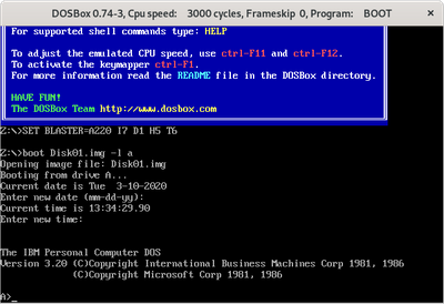

I work for an archive in Berlin/Germany and in our stock are a lot of BackUps from the 80ies, amoung them many of DOS-BackUps (RESTORE/FASTBACK).
We use DOSBOX sometimes as a virtual machine to run the old systems in original enviroment.
It works all well how Great Hierophant above described, but obviously not for IBM DOS 3.2. I have a BackUp here from some IBM DOS System from 1988 which was running on IBM DOS 3.2. If I install that DOS-version, DOSBOX refuses to boot completly from HDD-Image, but to boot from the image from the bootable IBM DOS 3.2 floppy image (A:\ drive) works. All other DOS-versions I tried work fine.
Problem number two, you may help me, is, that I can only mount two HDD images at once (drive number 2 and 3, C: and D:, hda and hdb), but the original System, which I try to run, used three HDDs...
Do someone know, why IBM DOS 3.2 don't boot from HDD and can help us to fix that problem?

I don't know what the problem is, but as a test I tried booting a disk image of PC-DOS 3.2 in vanilla DOSBox 0.74-3 and it worked fine as you mentioned.
17.68 KiB
13689 views
Perhaps you should provide some more details as to what is going wrong. Also any debug messages.
I did notice that a HDD image made for a newer DOS version was seen as a non-DOS partition with PC-DOS 3.2, and PC-DOS 3.2 FDISK does not give an option to delete a non-dos partition.
I was able to delete the old partition with DEBUG (http://www.after10.net/Debug.html) and then create a new partition with FDISK, after which dosbox restarted and quit. After that I could not IMGMOUNT the HDD any longer. Getting an error "Can't create drive from file."

Ok, I was wrong. I was able to create the hdd image with dosbox-x's imgmake command and mount it.
IMGMAKE hdd.img -t hd -size 20 -nofs
IMGMOUNT 2 hdd.img -t hdd -size 512,32,2,640 -fs none
You will notice the "2" instead of "c", this is necessary to mount it on the second device (hda), specifying "C" will not work.
Then you can boot the dos disk, and run fdisk to create a partition.
BOOT Disk01.img
fdisk
fdisk will cause a reboot and you need to do the above IMGMOUNT and BOOT commands a second time. After this you can format c: and copy the dos files.
format c: /s
mkdir c:\dos
copy *.* c:\dos
Restarting dosbox, I could now boot directly the HDD image without the diskette image.
IMGMOUNT c hdd.img -size 512,32,2,640
BOOT -l c
All of the above commands will work exactly the same in vanilla DOSBox or DOSBox ECE, with exception of the IMGMAKE command which is unique to DOSBox-X. But you could always use 'dd' on Linux to create an image file yourself.
dd if=/dev/zero of=hdd.img bs=1024 count=20480
will create an equivalent 20MB file, identical to that created with IMGMAKE with the -nofs flag.
