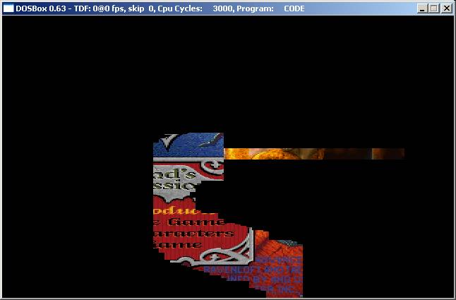

I tried the version dosbox_kronuz-20051213.zip with Ravenloft 1 and it is completely unusable in window mode (fullscreen seems to work ok).
After starting there is an empty screen (though the music play). Mashing keyboard/mouse I get further but it seems to have big problems with screen updates... For example sometimes it updates the screen only on places where the mouse cursor was... See the picture from intro... In the game itself the mouse cursor is invisible or it its picture remains on the place where it used to be... In short - the screen update does not work properly...
I used the default settings in DOSBOX.CONF (just started DOSBOX.EXE and generated the new DOSBOX.CONF). I use Ravenloft 1 with DOS/32A extender (but I guess this should not have any influence here)
I have Athlon 1Ghz with 256 MB of memory, WXP SP2, GF2MX with 32 MB of memory, the driver file version is 6.14.10.78.01.
Edit: This seems to be a problem only when output=surface - this is broken, other output modes seem to work ok (though I did not check them extensively)...
Mirek
