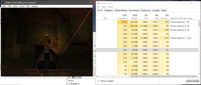

Reply 1494 of 2397, by matik7777
I switched over to opengl in dosbox config.
Started a GLQuake and it actually works, thought as you said, it is not 100% stable.
There's some weird graphic artifacts (looks like hard OC) and it's doesn't have solid FPS - I assume that my host CPU still is a bottleneck.
However, the host GPU usage can clearly be seen.
I have to try some other games.
EDIT: DOSBox-X does not utilise more than 40% CPU usage. Does it have some kind of multi-core functionality?

No, but I did restore the dynamic core some time back by popular demand.
