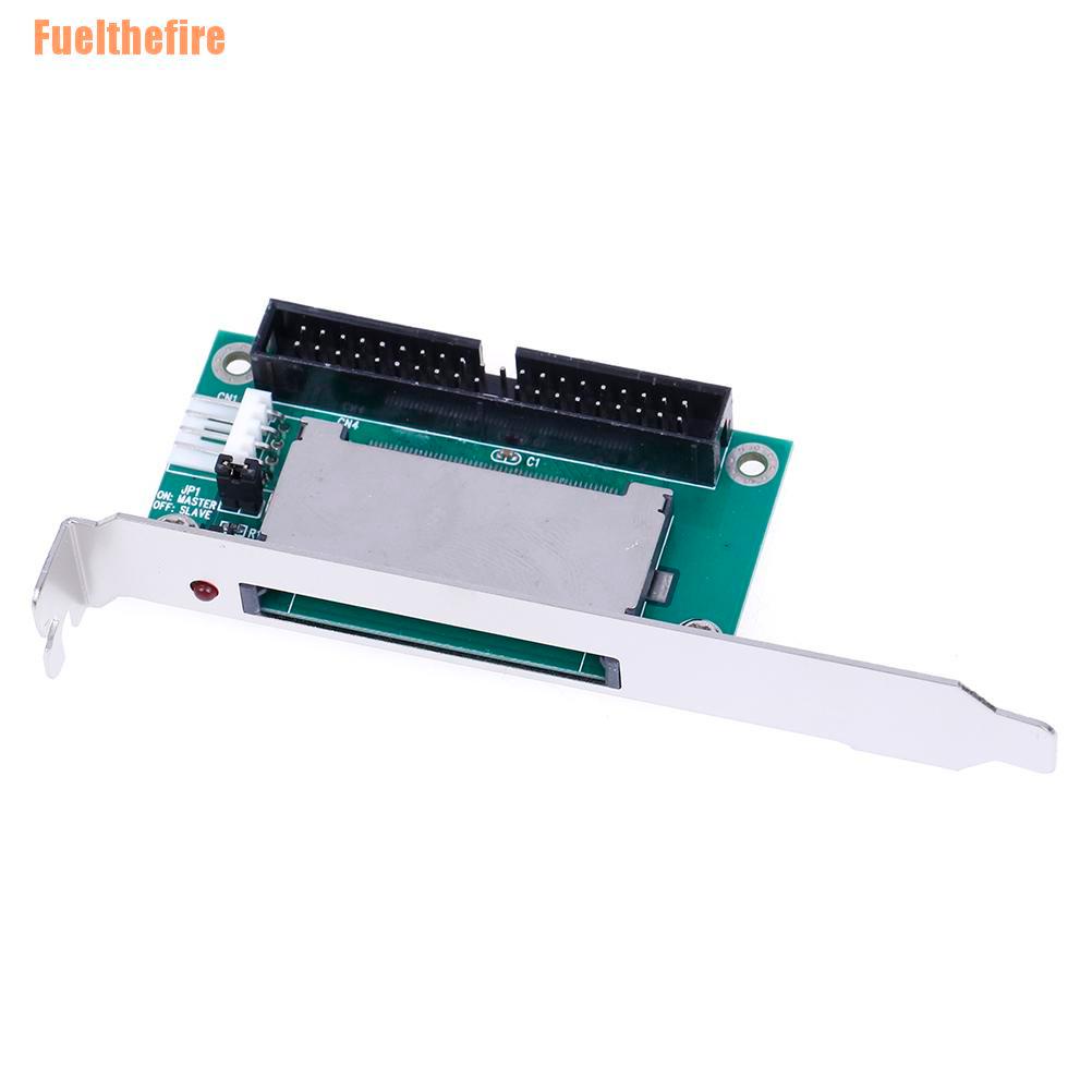

Hi guys. I often have to re-buy these cheap adapters, they seem to be fragile, especially after you remove/re-insert CF disks a few times. Can notice the soldering is pretty bad. Are there any better alternatives ?

The first model showni in this thread is lowest quality from China, I think.
Had a few in the past, too. Has short circuits sometimes, even. Not recommended.

I like the first adapter shown at the top of the thread because :
1) male connector allows the use of 80 pin cables so you don't have to short pin 34 to get ATA66 & faster
2) have an external activity LED
3) are cheap
But they are fragile. I usually have to add a some solder to the points that hold the metal shield to the board.
I made a bracket design for them that I can print out at my local library. Here's what the finished product looks like:

I'm using an adapter like the one showed on opening post with a 80 pin cable. for what it worth.
Bios shows ata 100 and windows udma mode 7.
