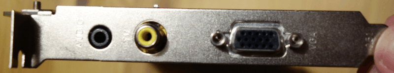

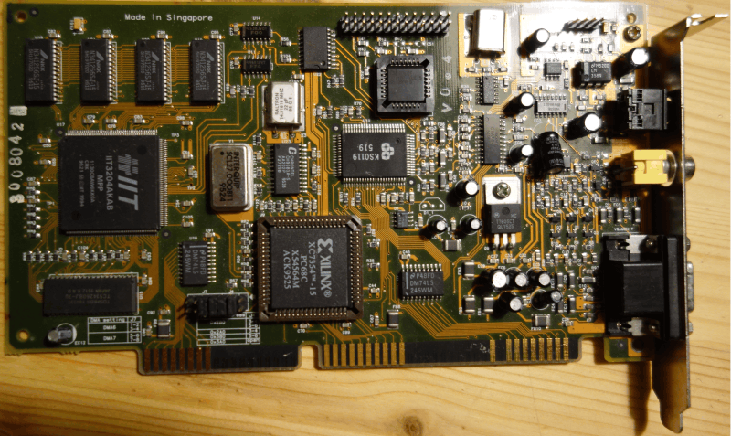

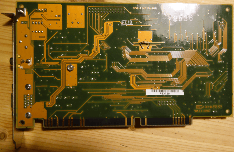

Generally Im'm pretty adept at identifying components, but this time a card has me stumped.
It's a 16b ISA card with Xilinx XC7354-15 and IIT3204AKAB chips, 128kB of SRAM attached to the IIT chip and a VGA (Dsub15), RCA and audio connector. No FCC ID, no vendor or model name. Just "Made in Singapore" and a 9536 date code.
Anyone able to nudge me in the right direction with this card?

Reply 1 of 5, by dr.ido
It looks like an MPEG1 decoder card for playing VCD movies.
Reply 2 of 5, by dionb
Ugh yes, that was a possibility I hadn't even considered. Would make it less than useless to me even if I could find the info needed to get it to work. I suppose I could always transcode a certain famous Rick Astley song and give someone on some old hardware a bit of a surprise...
Reply 3 of 5, by Malvineous
Is that a VESA feature connector on the top? I wonder if that's how it gets the video signal to output on the VGA connector? If so it might be worth keeping for that alone - cards using the feature connector are very rare.
I have a 16-bit ISA video capture card of similar age and it's a much larger card, so on size alone this could well be "just" an MPEG decoder card.
Reply 4 of 5, by dionb
The thing on the top is almost certainly a VESA feature connector - no way could the ISA bus handle the amount of data needed for raw video to or from the decoder card. It's labeled 'CON 1'.
Reply 5 of 5, by RetroFletch
Know it's a late response but this card was sold as the Commodore mpeg pro 😀
Can find fcc Id if you search for that, seems it was manufactured by aztech
drivers seem impossible to find.
