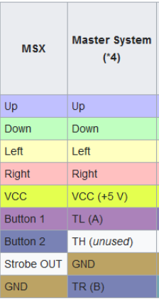

Reply 3 of 4, by MAZter
Looks like it's not compatible with MSX gamepads 🙁
